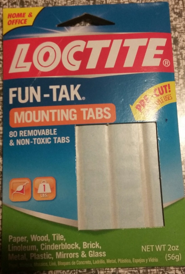

What I do is stick some dum dum in with the nut and it holds it in place and never will disappear. What is Dum dum..its any gummy material like stick em , picture hanging putty ..anything like that will work.
Re: battery issue
This stuff holds quite well, just like dum-dum. You can find it almost anywhere now. Use a knife to cut off one of the squares. Then cut that into 4s. Use two on each of the terminals, one on each side...or you can try to squeeze some under the nut. It won't come loose again. It is like a putty.
Re: battery issue
easyrider wrote:What I do is stick some dum dum in with the nut and it holds it in place and never will disappear. What is Dum dum..its any gummy material like stick em , picture hanging putty ..anything like that will work.
That's not a bad idea at all.
