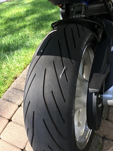

I must be good for the rest of my life on flats. What are the chances, who gets a nail twice in one year. This one is at an extreme angle taken on a braking action obviously. For its diameter this was a very long nail.

Growl! Do you trust a plug, or is it many clams down the drain? Can you put in a tube?

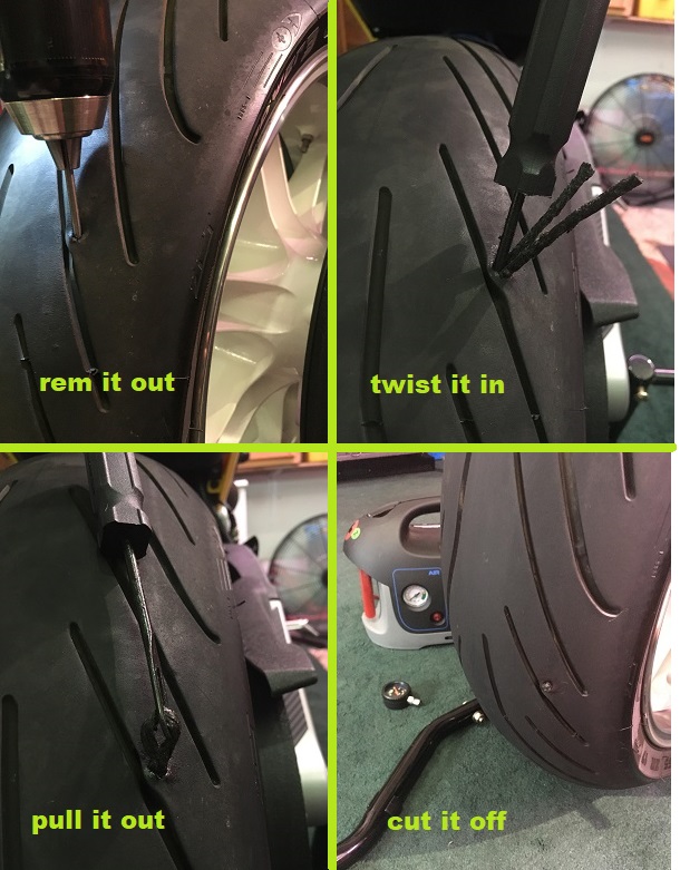

Like the last flat tire thread I posted before it went viral over the do's and don't's concerning plugs, they don't scare me. (must be a city thing) Just grab a drill with a 1/8th bit and rem it out. Insert (tar baby) plug all the way with tool, pull it out half way, cut off close to the surface. The only issue with this one might be the extreme angle this goofy nail pierced. Worse case she's flatter than a fifteen year old in the morning and new Michie on the way OR..... WE RIDE!

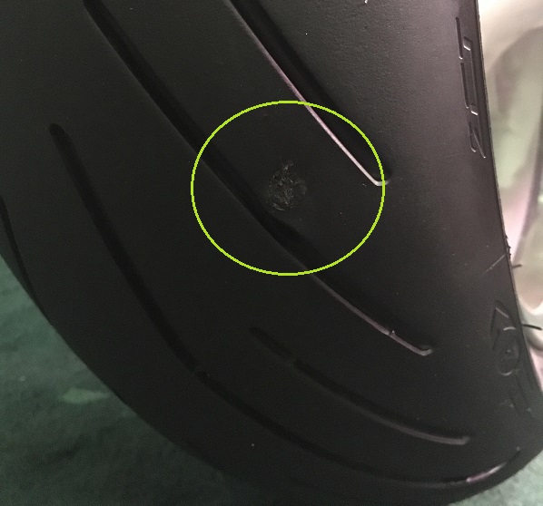

Not going to win a beauty pageant... but get me to winter and I figue I made it.

No pressure loss this morning. After a few miles last night it's not that bad either.alx123 wrote:Great job,looks like you perfectly NAILED it.homie wrote:Not going to win a beauty pageant... but get me to winter and I figue I made it.
