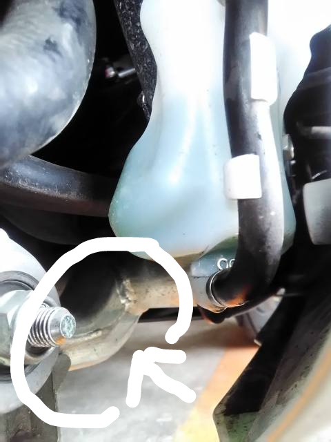

I caught a glimpse of this..dang! :o
A removable fluid line where you can easily drain the coolant without removing all the plastic.. :roll:
So yeah, maybe some of you will someday accidentally overfill your coolant reservoir..there's an easy way to drain it.
Thanks for posting those radiator/coolant bottle pics. . .. Good tip about the drainage. 8)

Re: Overfilled my coolant reservoir
I was looking at your picture and I noticed what looks like a Crack. Is it just the light or is there a problem?

@Mel I will a closer look later, thanks for the heads up

Mel46 wrote: I was looking at your picture and I noticed what looks like a Crack. Is it just the light or is there a problem?
I took a closer look and there's no crack. It's part of the chassis holding the engine. Thanks
