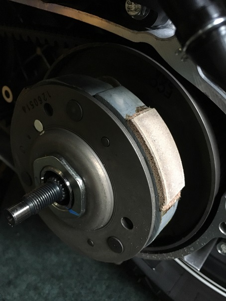

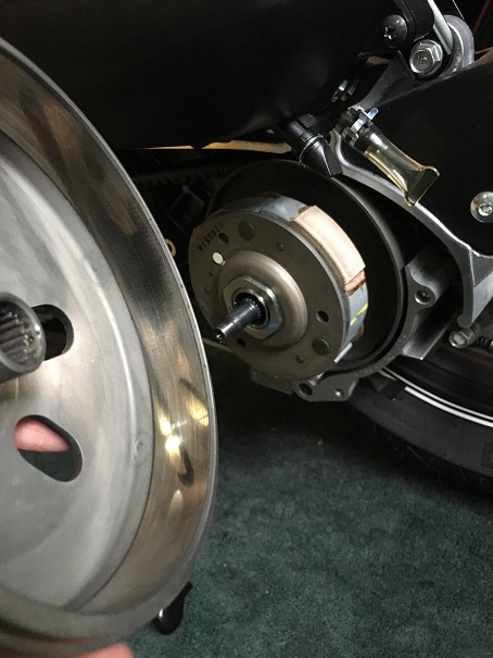

Going to make cleaning and sanding the clutch shoes a part of routine maintenance. Used Purple Power degreaser on the clutch outer race and 3M 600 grit wetdry sandpaper on the clutch shoes. A fine line between greasing your bearings and causing a problem for the clutch operation. Melted grease was gathering on the inner edge of the race and sneaking under the shoes intermittently, glazing the shoes, slipping and making weird noises.

I hope you don't have any future clutch issues,but typically once the material is contaminated it should be replaced.The fibers absorbed the oil grease and will come to the surface after heating up.I think metallic material is less affected and cleans better than Kevlar.However,what the hell may as well give it a good shot at sanding and cleaning and maybe all will be good.Not a big deal to replace the clutch pads and might be a good option as most shuddering issues are cured by using the 110 pads.They are significantly smoother . Installation video is available .

It's not a new idea to sand the shoes, been presented in here since I membered. Not sure how long I will benefit from it since I obviously over greased the FACE DRIVEN bearing more than the 7 grams because I overdue everything (except my tech videos

Thanks, that was an informative video. I have found your better clutch weights on ebay. Now that I see there are available there must be more that can be done to remove contaminants like oil and grease from existing clutch shoes. I wonder what temperature would burn off the petroleum from the saturated shoes? I'm of mind to discover a way to not replace shoes at the first sign of shudder. Lets cook my clutch weights and bake them dry for educational purposes. Suggest a temperature and I say we fire up the toaster oven. The average member isn't going to take on that job like you and I would... skill level is to high.

Been out trying to make it shudder by running it hard and anticipating more grease melt down getting on the clutch shoes and sure enough I was able to produce more muck on the shoes and race. So I removed all the grease from the bearing, heated it up with a hot air paint gun to melt it out and replaced with ever so little new marine quality grease on those two inner bearings. Then I mopped up again the clutch bell and shoes heating them to several hundred degrees until dry and re-sanded. All back together shiney and clean we RIDE SOME MORE!
There simply must be a way to recover tainted clutch weight pads, I will find it!

In conclusion from MY shudder experience...
Facts;
Shudder came from the clutch.
Weight shoes contact with the race in the outer bell were contaminated.
Too much grease from the Driven Face (2) bearings inside the clutch assembly leached into the bell.
Solution;
Remove all old grease from bearings and re-apply much less than 7 grams.
Degreased the clutch outer bell and race removing any and all petroleum.
Degreaser on the weight shoes and light sanding to rough the surface of each shoe.
Apply heat to each pad from a heat gun to a VERY hot temp burning off any petroleum saturation inside the pads.
Sand lightly again, reinstall and hope for the best.
Just put 30 miles on this process, no shudder, no squeal, pulling hard and feels right as rain.
