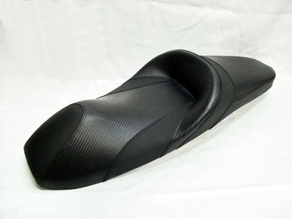

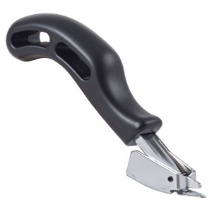

Well I have my supplies for a seat modification
- pattomike
- Posts: 169
- Joined: Fri Jun 02, 2017 7:47 pm
- Color: white
- Location: Boise, Idaho
I am going to rid my seat of the drum. That is the part of the seat cover that stretches over the top of the step-up, and leaves a hollow drum where the driver sits. I bought a heavy duty staple remover, and an electric stapler. I picked up a couple of 2 inch thick 18 x 18 premium density foam squares from Walmart, and spray-on adhesive for joining the two squares together if needed. The only thing I don't have is a grinder. I am bewildered about what I need for the grinding task. I have some sandpaper so I guess I will try using that initially to shape the foam. I am not very handy, and I live in an apartment. So I'm not exactly psyched about it. I just want the seat anxiety to be over. My goal is to fill in the void that is the drum, and then blend the foam in with the front of the seat. I sit on a blanket when I am riding, and it makes riding more comfortable because I am not sitting so low. Sometimes I sit on the passenger sit. I can even flat foot while sitting on the passenger seat. But I do not think it is safe to drive like this. I would like to carve out some of the foam that makes up the step-up, but I think there is a plastic wall behind this foam so there is nothing much I can do about carving out the wall. Any ideas, suggestions, experiences are welcome. Here are some pics of whatever I can find to share. I haven't taken any project pics, yet.
- seat 01.jpg (109.06 KiB) Viewed 4647 times
- crain-126_2.jpg (10.18 KiB) Viewed 4647 times

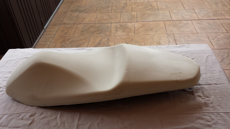

I made an incredibly comfy seat on my Kymco.
Used actual seating foam from online supplier, 4 way stretch Sailrite vinyl (see their motorcycle seat rebuild on utube) to recover with, mechanical staple gun, electric knife, spray glue, block of wood and tack hammer to fully seat new staples.
Took me 3 days, many road running sitting tests before recovering. Cut away some, but mostly built upon existing seat foam. Glued on and trimmed new foam.
Remove cover staples with needle nose pliers and small screwdriver.....now you lift off foam to see seat pan.
I added inches of foam....over ridge in pan. Widened and squared seat edges for broader seat, sloped front UP to prevent diving upon braking. Used harder foam with cutouts for plastic protrusions, and in nose and tail of seat. Then softer foam over firm foam concaved a bit where I sit.
TEST and Test some more. Cover with trash bag. RIDE IT to test - before recovering.
If you need to lower seating height while retaining stock seat pan.....good luck. Seems you will end up with a hard, uncomfortable seat. I Raised My seat height some 2-3 inches and it is amazingly comfy. I'm 6'3".
