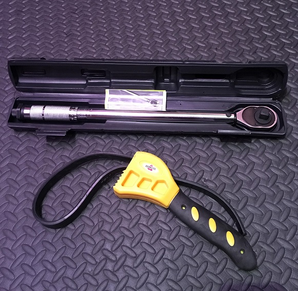

Re: I damaged my PCX
You can do this, Its true the NCY drive face does not have the holes to apply the tool. No doubt a choice made to lessen the cost of manufacturing. But all you need is a trip to harbor freight for a large oil filter tool (a big one with the adjustable rubber belt). Also they sell a huge torque wrench for less than 20 dollars. Placing the oil filter tool is tricky but I've done it many times to hold the face while achieving the 44 foot LBS.outlander wrote:I just checked the crank thread and splines, it is ok. I'm looking at online pics of the ncy drive face and there is no where to hold it while torquing it.
I'm thinking of taking it to a Honda dealer to reinstall. Any idea how how many hour labor the charge would be?
- unnamed (2).jpg (159.9 KiB) Viewed 9419 times

Thanks for the strap wrench tip. Interesting though I've watched about 10 variator install vids on YouTube and all of them use an impact wrench with no problem.
I have used that holding tool for taking it off. That belt might be a better option for putting it on though.
