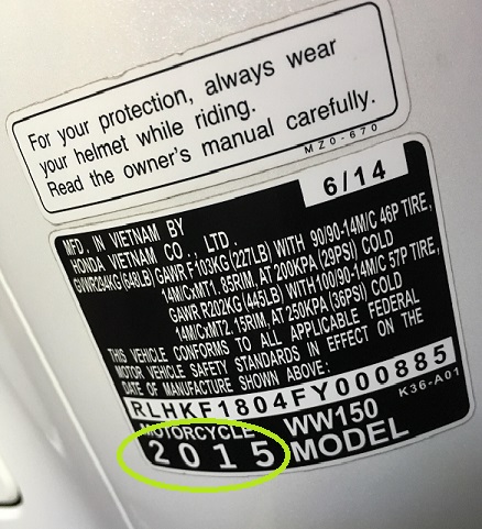

Vince wrote:I have a 2014 PCX150.
Do I need to replace something? Will Honda pay for it (without an extended warranty)? It seems like a manufacturer's defect.
Hey Vince, here is the most common assembly we have seen needing to be replace. #8 FACE SET, DRIVEN OEM part 23205-KWN-640
http://www.bikebandit.com/oem-parts/201 ... #sch794095
Have a look at the sticker under the steering column for the year of your PCX. Bike Bandit wont list parts for a 2014, the year PCX was being redesigned into what we now know as the LED models. You either have LED head lights or you don't that will decide what year parts will fit your bike. Have a look when you get a chance, very few people report an LED PCX with a 2014 manufacturing date... Cool!
