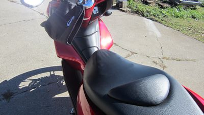

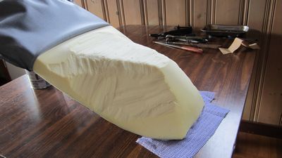

I took my PCX to a local shop to see about getting different shocks, he advised against it. Said I could get different shock mounts welded on, but thought that would void the warranty so didn't do that either. Next I took the seat to an upholstery shop that restores motorcycle seats, they said there wasn't really enough foam to shave off to make much of a difference. What I hoped was that they could cut into the round plastic part of the front underseat and plastic-weld it lower, but they couldn't. So, frustrated, I marked the part of the seat I sit on during long rides, took the cover off and started shaving foam in front of that. I took foam off the top and the sides of the seat with a kitchen knife, then sanded down the harsh edges with 150 grit sandpaper. Then I recovered it. Now I can slide forward when I stop and get both feet on the ground almost flat, and slide back to the comfortable foam part to ride. Works for me.

The cover is pretty smooth, not perfect but good enough.
