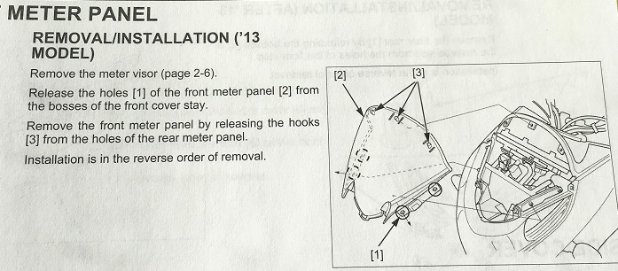

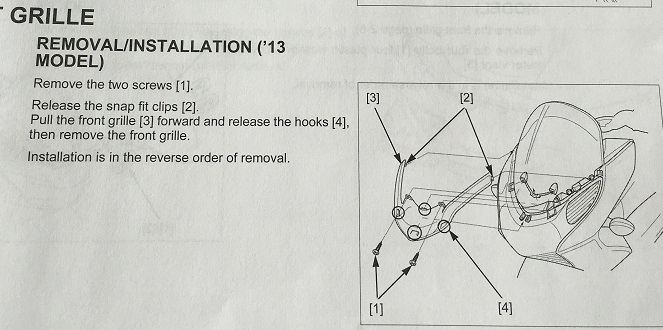

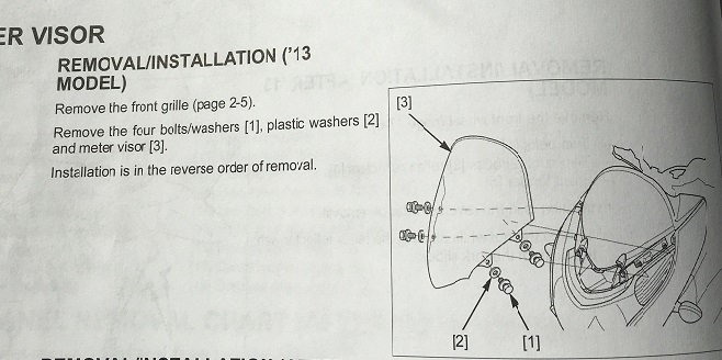

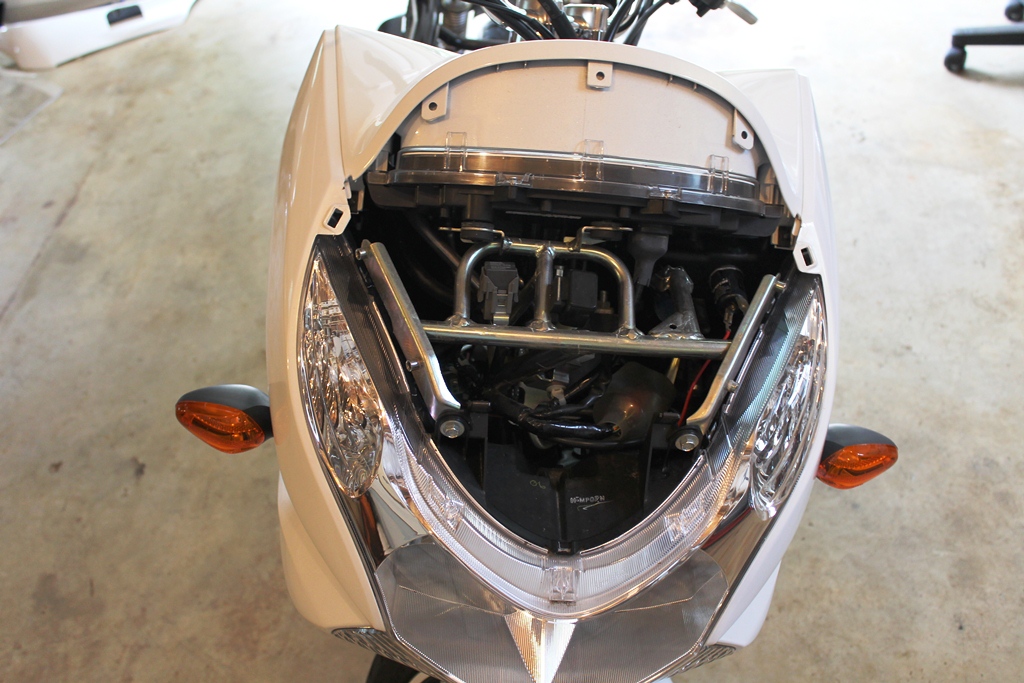

Remove the screen, remove the black plastic clock shroud beneath the screen, remove the trim which runs above the headlight across the front.
This gives just enough access to adjust the mechanism with some short spanners. Access is still a bit tight but it can be done.

Re: Rear brake system. How to access the front inner mechani
Couldn't find a diagram and this photo is the best I could do.
Photo is taken from http://www.hondapcx.org/viewtopic.php?f=3&t=2630
- file.jpg (308.94 KiB) Viewed 1659 times

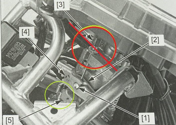

(1) First rear brake cable connecting to the equalizer
(4) second rear brake cable connecting to the equalizer
- 1.jpg (81.91 KiB) Viewed 1649 times
- 2.jpg (75.79 KiB) Viewed 1649 times
- 3.jpg (96.15 KiB) Viewed 1649 times
- 4.jpg (226.07 KiB) Viewed 1649 times

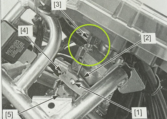

CAUTION: I hate talking about brakes in here... do be careful.
The green circle would appear to give additional adjustment to the (first) rear brake cable and not the (second) which is where you are needing to gather up some slack. To adjust the lock nut and thumbnail in the green circle would be WRONG in my opinion as that would set the master CBS equalizer out of calibration.
PLEASE look for a lock nut and thumbnail on the second rear brake cable below the green circle #5
The picture and the SM do not show me or look like there is an adjustment and that would indicate to me your second rear brake cable has stretched beyond its limits and its time to replace the cable.
Don't die messing with brakes... go to authorized dealer
