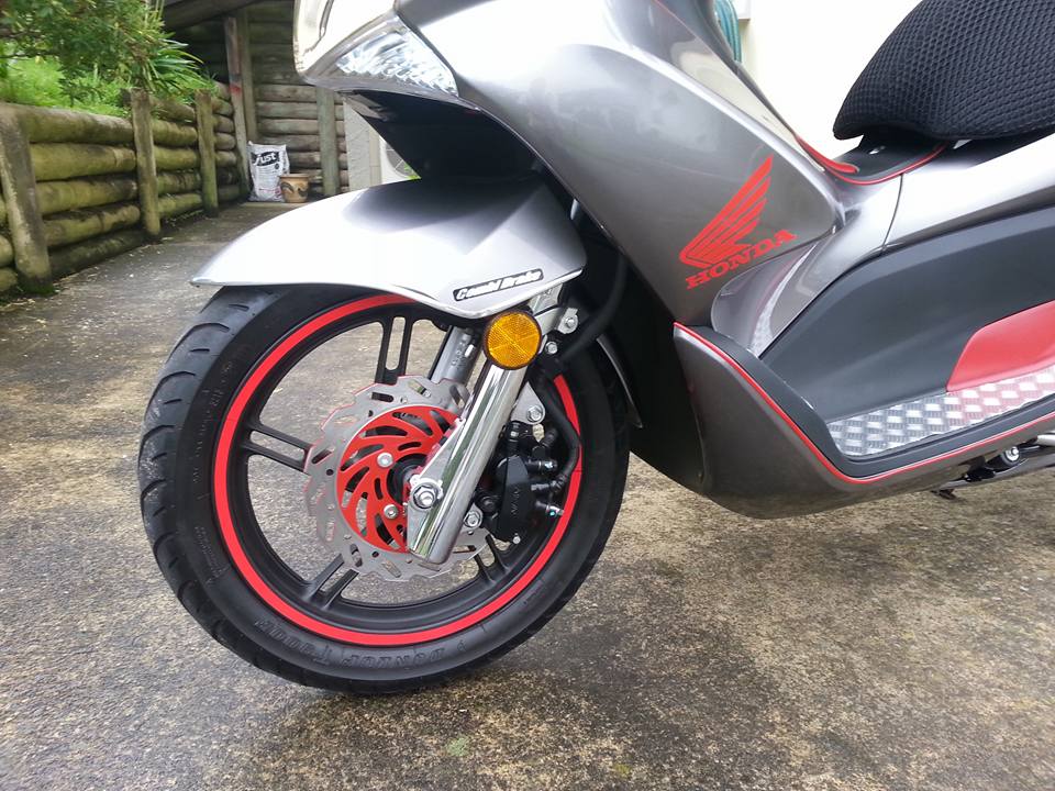

Newly installed Rotor disc and Pass switch
- pcx2.jpg (114.43 KiB) Viewed 5847 times
- pcx1.jpg (73.48 KiB) Viewed 5847 times
- pcx.jpg (126.4 KiB) Viewed 5847 times

DAHAM, smack down, BOOM! that's BEAUTIFUL! You must look like a turd when you sit on it because what could one possibly wear to compete with that? No bag of blood and was is worthy to mount that bike.
Re: Newly installed Rotor disc and pass switch....
Hey choice cuz, that's not a bad looking rotor, where'd you score that from? Is it 220mm, still?

the size is the same with the stock rotor, i bought it from Philippines..chicaboo wrote:Hey choice cuz, that's not a bad looking rotor, where'd you score that from? Is it 220mm, still?

the rotor installed wrong direction, isn't it?
It would seem that wave rotor is installed backwards... ouch!Vancho wrote:the rotor installed wrong direction, isn't it?
Pads will be destroyed in no time right? Didn't know you could do that, learned me something here today about wave rotors.

His braking effort should be better at the cost of pad material I guess? If it doesn't shudder.

Why do you call your Hi Low beam switch a Pass switch. Mine does not have the words Pass on mine.
His switch has a 3 way rocker instead of a 2 way rocker.ItBeMe wrote:Why do you call your Hi Low beam switch a Pass switch. Mine does not have the words Pass on mine.
There is an extra momentary switch that if you flick down will briefly flash the highbeam.
This is known as a pass(ing) switch, and is more common on motorcycles.

We've all been there, you would rather know than not know about the wave rotor i'm sure. Come on back and tell how it's possible the rotor is reversible and were there no instruction with the purchase. This might be too easy to do for any of us.
