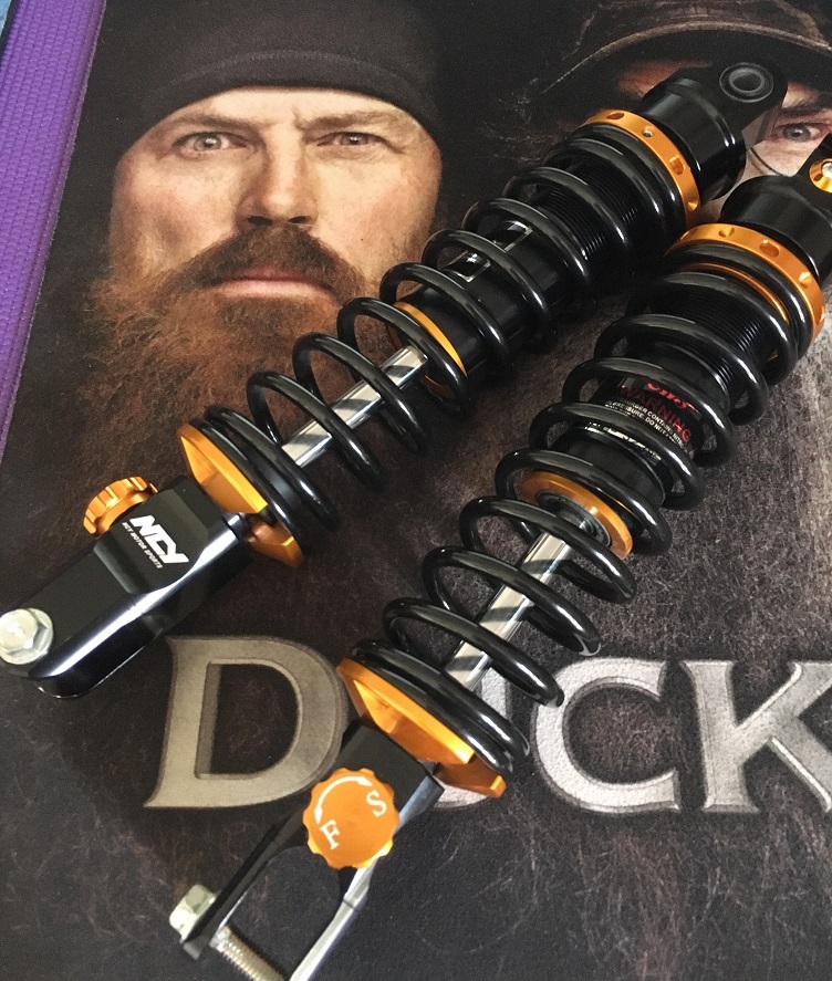

Quote from advertisements on the net....
Nitrogen dampening action via a small knob, allowing to dial in the perfect setting for your particular riding conditions and preferences.
That's it? Does anyone know what the adjustable collar on top is used for? Sorry I didn't get instructions with these used ones and I'd like to test them properly.
- unnamed.jpg (282.56 KiB) Viewed 4995 times

The collar at the top is the same as coilovers for a car, they let you adjust the length of the shock so you can raise/lower the bike a bit. In turn ,it adjusts the preload of the spring at the same time.

They won't change the stroke length, they just increase the compression (pre-load) on the spring to make them firmer. They are always 310mm long CC for example.Jge64 wrote:The collar at the top is the same as coilovers for a car, they let you adjust the length of the shock so you can raise/lower the bike a bit. In turn ,it adjusts the preload of the spring at the same time.
The dial at the bottom increases or decreases the eyelet that the oil passes through to increase or decrease the damping rate (bump only usually, but not rebound).
