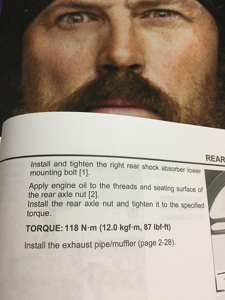

I was wondering what the torque values are for replacing my rear tire. I've been able to find the how to's just not the torque values. Thanks
Re: Rear tire replacement torque values
Ah yes, why I always put torque values in my video's. What good is saving the money doing it yourself if it ends up costing you more when it falls apart. Trade you this for your location in your profile 8)
PCX rear axle nut torque (not Forza) yes it's a wet torque
