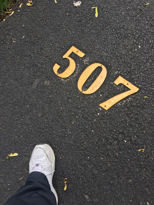

When the asphalt is hot enough to fry an egg place whatever you want to say on your driveway with those brass letters you get at home improvement stores. Put a board over the numbers/letters and park your truck on it for the afternoon. Had these embedded for several years now and they draw as much attention as a PCX in a parking lot
This is a homie original, like the stable style garage door - fun for old men
Not going to work on concrete and surely must be out there on facebook by now. If not, someone should do the 'how to' video and post it.

Liquid nails would work on concrete, it doesn't have to be embedded. Might also stop neighbourhood skateboarders

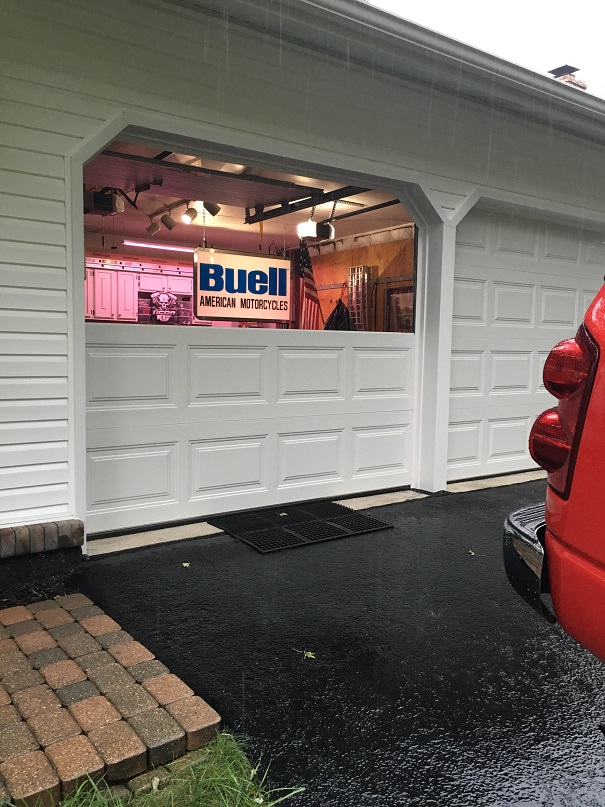

Awesome garage door.
Mine is beginning to show signs of age and deterioration. Had thought about making my own or just paying the grand and having someone install a new one. Leaning towards having it done. . ..
Did you make that yourself or buy a kit or something? And it definitely does allow enough space for a horse. . .although a clever one would jump that and disappear into the wilderness like Chief at the end of One Flew Over the Cuckoo's Nest

No problem, sounds like you are going a different direction with garage doors. To do what has been done here (top down bottom up) automatic garage door would require the following;PCX150Rider wrote:Oh and thanks for offering to show the mechanicals on a video but since I'm still in the decision making phase I don't want to waste your time. If I do though I'll give you a shout. If it's lasted two years it should last twenty right? . . . at least the metal stuff.
Single port doors (not those giant two car entry doors) dead lifting the top half would be too great for the opener.
Parts;
4 lead carriers - 5.00 each
2 slide locks - 8.00 each
1 brass security lock (like used in an apartment to slightly open door before allowing access) - 5.00
Maybe one hour or two of your time to install and adjust for smooth operation.
No need for concern as everything is reversible if you didn't find it totally useful... but trust me, you will
Keeps leaves, cottonwoods, animals, blowing snow and vagrants out of your garage while enjoying semi open doors.
Confines your animals and vents whatever fumes from paint or fuel. I go a step further with a mosquito net in the season while working long after dark. Its a beautiful thing yet you can't buy it

To be clear so folks don't try to use the mod on a LARGE single garage door. This is for one or both of your individually operated two car garage door designs. Why only for small doors? Well we need to gather a basic understanding of a counter balanced garage door first.PCX150Rider wrote:When you had your door installed originally was it like every other single wide garage door (basically)? No
After that you took the existing garage door and tweak it, or convert it, to your design? Yes
Sounds like if I had one installed then I could just convert it later on after if I understand you correctly. Yes
And a mosquito net? Another good idea.

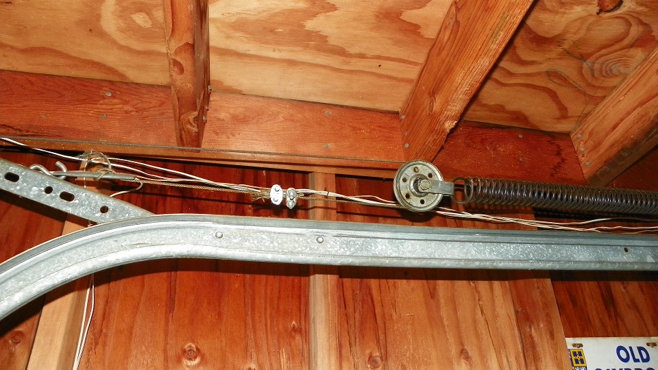

Torsion spring design doors are what we are looking to modify here... not the extension type. So if you have the (torsion spring) garage door design you can continue to entertain this project.
WARNING! these torsion springs are powerful and can be deadly, you go no where near them for this mod.
1. First buy two common garage door locks and install them in the pre-cut knock outs on both sides of a one car (single individually operated) garage door. (no need to mod both doors) You will find the knock outs about hip level below the mid section of a four panel door on both sides.
WARNING! Do not leave these locked and operate the opener yet. You can go ahead and do this first step while I do a video but until you complete the entire mod don't lock the door down and walk away for any reason. Once the original hinges are removed and new lead carriers are installed this warning expires and damage can no longer occur when openers are powered up.
Example of failure; You are happily testing the positions of the new locks and your wife drives up the street and uses her remote opener while you have the locks engaged
the door to operate typically.

I have the extension type installed on my existing door. . .. When a cable snaps they can get your attention as well. I've had to do a few Rube Goldberg kick the can down the road a little further repairs on it already.Torsion spring design doors are what we are looking to modify here... not the extension type. So if you have the (torsion spring) garage door design you can continue to entertain this project.
It seems the torsion type springs use a twisting action in lieu of the more linear extension type?

I think you are out bro, I would revisit this project if you ever replace your old doors completely with torsion type. I won't say for sure as I have not seen (extension spring) counter balance garage doors. Expect to be set back about 1200.00 for two new insulated automatic doors and openers. Home Depot did mine recently because my wife had banged them up over the years with her excellent driving skills. I immediately preformed the mod againPCX150Rider wrote:I have the extension type installed on my existing door. It seems the torsion type springs use a twisting action in lieu of the more linear extension type? yesTorsion spring design doors are what we are looking to modify here... not the extension type. So if you have the (torsion spring) garage door design you can continue to entertain this project.
As for safety precautions,
Two locks means double action would have to happen before you accidentally let the bottom half loose.
A slight notch in the lock bars will make it impossible to release the locks under pressure anyway (video will show).
Because you are dead lifting the top half with the opener when you lock down the bottom half (disengaging the counter balance) the question is will this stress the lift system? After a dozen consecutive cycles on a hot day these modern openers over heat and shut down for 10 minutes cooling and reactivating automatically like a blow dyer safety switch. This does not happen on the normal setup so yes there is concern. I tested this until shutdown (failure) but who does this much constant opening and closing of a garage door. Will this mod cause premature wear on the lift belt/chain or openers motor? I don't see this yet and the other un-modded door is there to compare. It's been a couple years now and I use this mod so much I just can't imagine not having it so replacing the entire opener/track system is about 150.00 if premature wear did cause failure over the years to come.
