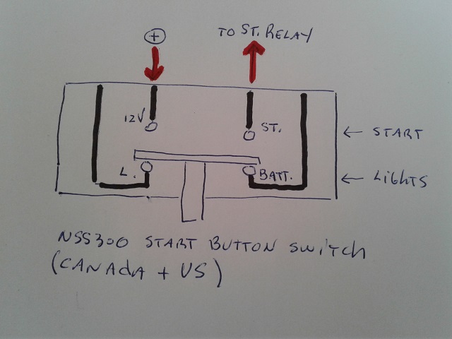

The manual says that headlight should turn off when operating the starter motor (page 28) but I noticed that they never turn off (low beam nor high beam) while I start the motor... did somebody verified this ? is it a problem ? any explaination ? (NSS300A)

François,frenchkiss109 wrote:The manual says that headlight should turn off when operating the starter motor (page 28) but I noticed that they never turn off (low beam nor high beam) while I start the
Here is how the starter button switch is built. The two wires disconnecting the
lights - as the button is pushed- are NOT used in North America. Looks like the Euro model is the same.
(I am very happy about this, since the high amps used to toast the switch on models that had the
lights connected).
- 20170422_182011.jpg (64.64 KiB) Viewed 4126 times

Thank you very much Aguim for that quick reply. So if I understand what you mean it is not a problem and it is better like that (not cutting the light circuit) for the health of the switch ?

Everything you mention is normal, according to the factory wiring diagram I have, here.
You could modify that wiring to suit your wishes, but that would be quite a hassle, as I dicovered
when I added an alarm and flasher buzzer on mine (then some witty old crank told me, 'why an
alarm, nobody would think of stealing that pig' ...hahah.

Then yes, the arcing from repeated on/off cycles ends up frying those tiny switch contacts. Same
with the dimmer switch, but it takes longer as that switch is not used as often as the start button
one. Some people install high-amps relays to protect the switches - using oem Honda relays
should be fine.
Come next winter, I think I should clean the dimmer switch contacts and add the 2 needed
relays (another hassle, has to be done perfectly right).
should be fine.

I put in LED headlight bulbs which I presume draw less current and so the Forza starts better???
I just wanted the white lights. My crashed (by the former owner) Forza has floppy headlights which burned out Halogens quickly. I need to glue them in better some time. But taking it apart will probably break more fragile parts.
