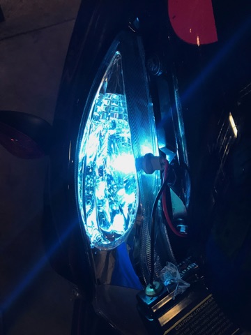

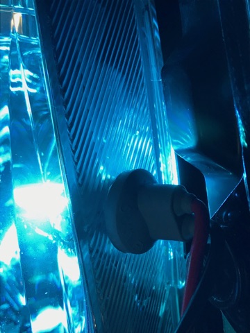

I was looking for a way to install LEDs in the international non-US turn indicator location. I didn't feel like dismantling the whole scooter to get to it so I tried a different angle. I popped off the trim between the lights and the windshield. I drilled a hole in the top edge the correct size for a 194 socket. Installed an LED and it worked! That's the good news. The bad news is one of the LEDs popped out of the socket as I was installing it! Right now it is sitting in the bottom of the light housing. I put a little glue on a stick and I'm hoping it will stick to the LED and allow me to extract it from the housing. Next time I will glue the LED into the socket before I install it. I took a couple of pics with a spare battery to show you guys how it looks. I hope you like them!
- CR-V2.jpg (84.89 KiB) Viewed 6454 times
- CR-V1.jpg (71.07 KiB) Viewed 6454 times

It looks good. I don't know what the law says about blue lights on the front of the bike but I have seen some cars that have lights similar to that color. By the way, you can purchase a 'snake' that has claws on the end of it that you could use to pick up that bulb. It is a spring with the claw in it, so it bends easily enough.

They claim the lights are white. They are that annoying bluish white like a lot of new cars have. Thanks for the tip about the claw!Mel46 wrote:It looks good. I don't know what the law says about blue lights on the front of the bike but I have seen some cars that have lights similar to that color. By the way, you can purchase a 'snake' that has claws on the end of it that you could use to pick up that bulb. It is a spring with the claw in it, so it bends easily enough.

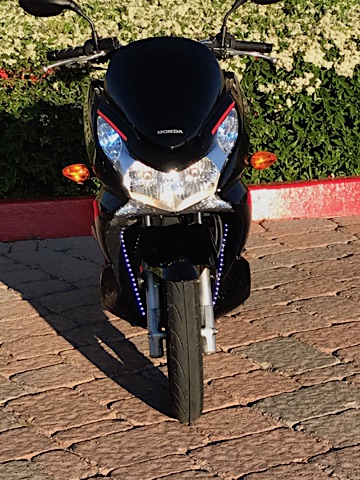

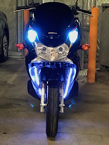

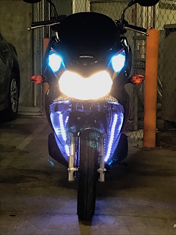

Finished! What do you think?

The upper lights look like they just belong there. Very nice job!
Re: Running lights
They look great, especially at night!

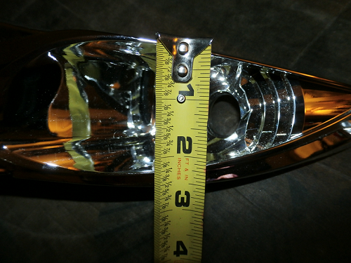

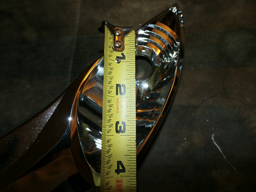

Dan, do you know the maximum depth a bulb could be and fit in the housing? Just wondering if you measured. Thanks.

I can do one better...The clear plastic lens over the reflector adds another 1/4"ScottDR wrote:Thanks for the interjection k2. The three switchbacks I am considering are the 1157, 3157 or 7443. But they are definitely larger inside the housing than the tiny 194 bulb the post originator installed. Hence my curiosity on the depth available at this easier to install location.
Dan, any chance you measured the maximum depth in the holes you created?

Sorry. I just read this. I didn't measure anything. Just eyeballed the bulbs. They were the 194 LEDs from Pep Boys. They fit just fine. A spherical bulb like an 1157 would require a much larger hole. Since i was drilling down from the top and not the back, that was my main concern. I used a piggyback fuse holder to tap the power. Key on, lights on.
