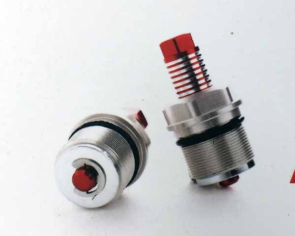

Just watched it. This is weird, they certainly look like PCX legs. I definately don't remember seeing any threads cut into the stanchions but there's really no other explaination is there? Well anyway, here's a closeup of the cap itself, evidently it's a spring preload adjuster.
- yss pcx fork cap.jpg (26.54 KiB) Viewed 12793 times

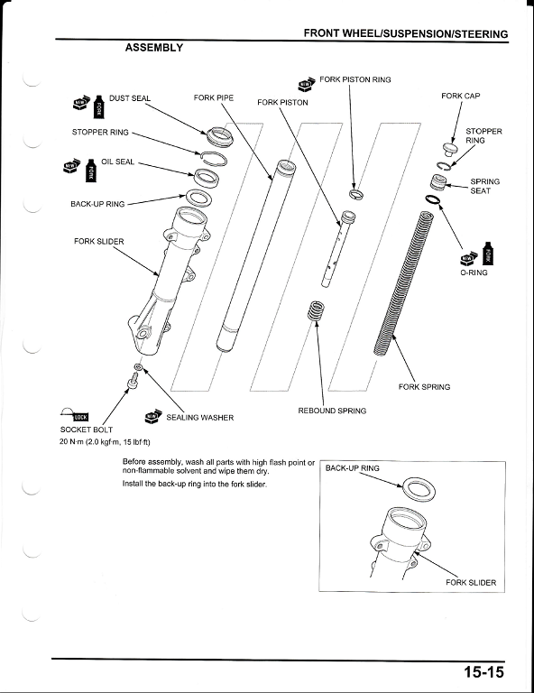

Re: Anyone fitted the YSS fork upgrade kit?
I just checked the Thainese PCX 125 2011 service manual, and there's no thread shown on DE XO LO...
Is there maybe a thread inside the stanchion that is not used by the stock top cap and retainer clip?

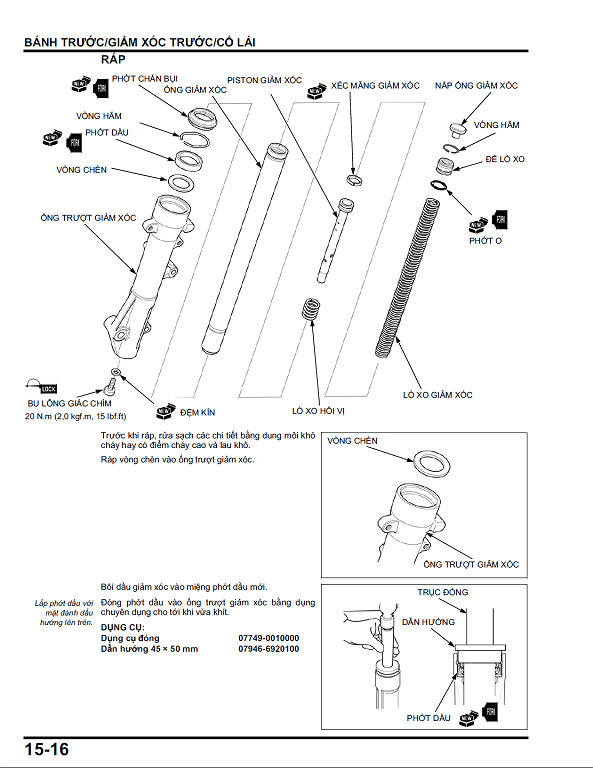

- Fork assy.png (115.84 KiB) Viewed 12794 times
- k2apache6.0
- Posts: 507
"Is there maybe a thread inside the stanchion that is not used by the stock top cap and retainer clip?"
Thats what I was saying, I don't remember seeing one, just a groove for the clip.
Re the pic you supplied: Another thing, Our top caps are all one piece we dont have a "NAP ONG GIAM XOC" bit, just the cap, 'o' ring, and clip
The English version of the V1 2011 PCX125 has the NAP ONG GIAM XOC, though.
- Fork assy english.png (125.23 KiB) Viewed 12787 times
