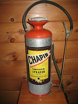

As an added note I found a miserly way to wash my motorcycles and soon to be PCX yesterday using a manual pump pressure sprayer to get the crap off my new Metzeler Sahara Enduro 3 tires I just had mounted for my KLR 650. I inherited it from my Dad and never thought to use it until now. We've been having serious drought conditions in our part of the country and the "conserve water" message has been passed around since last year.
Instead of getting out 50 feet of hose and going through that ritual I can just dump a gallon or two of water into the sprayer from and empty plastic jug, pump until pressure is enough, and I'm good to go. The nice thing is that you can adjust the nozzle from jet to spray and since it's light pressure you can work around the gauges and areas of the bike that you needed to be careful of before using the hose water off the house. It may not seem like much but I couldn't believe how far one gallon would go. But I'd recommend two gallons on an initial fill if you have one that will hold that much. Also, you have to be careful not to hold your face near the top of the sprayer when you go to relieve the pressure when you are done. . .twist slowly. . .allow the hiss. . .and keep your head to the side in case it goes rocket on you. Oh. . .the other thing is that since you still use a separate soap bucket you can mix hot and cold water as needed when you fill it up depending on whether it's warm or cold outside. Since there won't be a huge puddle at the end of the driveway passers by won't think you are draining the lake. :o
Re: Basic Tools Required for PCX 150 Maintenance
That is an excellent idea! I have often wondered how I could wash the tire areas without having to drag out the hose and end up getting the rest of the bike wet anyway. Most of my rides are on streets, so only the tire areas end up dirty. Thanks for the tip.
