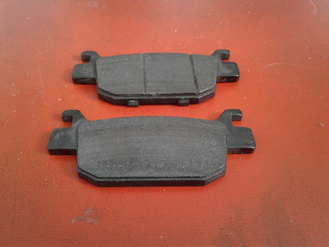

OK if I try this with the rear brake pads! (I changed those 'while at it'):
1mm left on the piston side, 2mm on the other one. Not impressive, but since everything in
the system was 'normal', I imagine we'll have to live with it .
