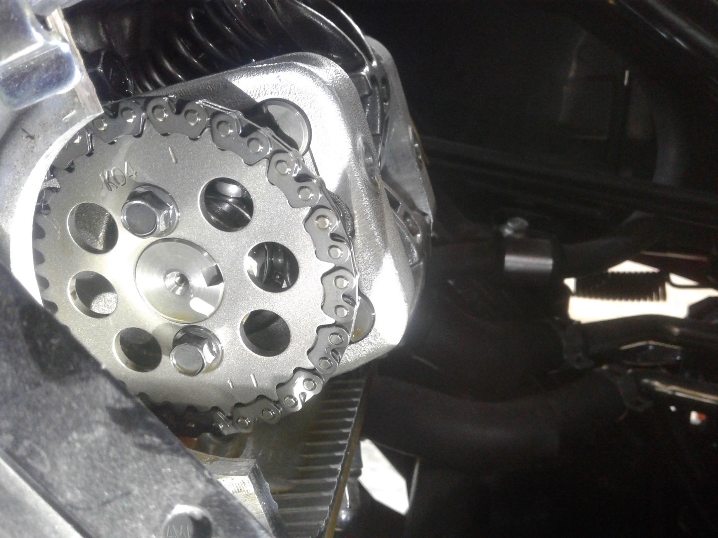

/attachment]Here's how your camshaft should look like, ready for valve adjustment. No need to line up flywheel
marks, nor worry about beeing on the right TDC, just turn the variator ccw till the cam looks
resonably close to this (took this photo from the right side, plastics removed):

Worked thrice as good as hoped! No way to erase 2 of those.
Anyway, clearances are :.006" intakes / .009" exhausts ,+/- .001" . Adjustment is done by pushing the rockers sideways and changing shims. On mine intakes were ok, exhausts both .008", @ 13000 km (still in specs).
TO BE ABLE TO UPLOAD, I HAD TO RE-SIZE THE ORIGINAL PHOTO by right-clicking it and selecting
appropriate pix's. Worked wonders, isn't it...

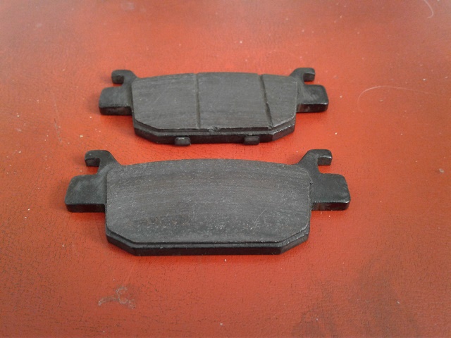

OK if I try this with the rear brake pads! (I changed those 'while at it'):
1mm left on the piston side, 2mm on the other one. Not impressive, but since everything in
the system was 'normal', I imagine we'll have to live with it .
