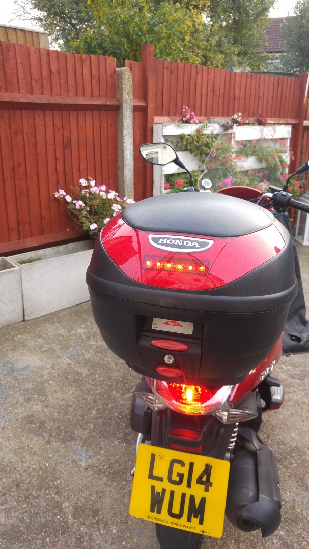

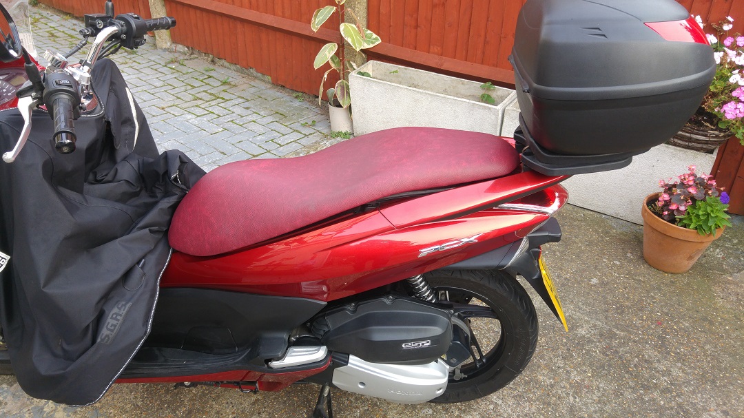

so few more words... or maybe few more photos so you can see my journey through PCXs
just shame I never took any pics of my first scooters
red one at the back was my 2nd PCX
my 2nd with standard lights and 3rd with added DRL for safety
then even more lights added
extra brake light
removed hump by cutting parts of seat out, some fiber glass repair, added foam and all re-wrapped in color matching

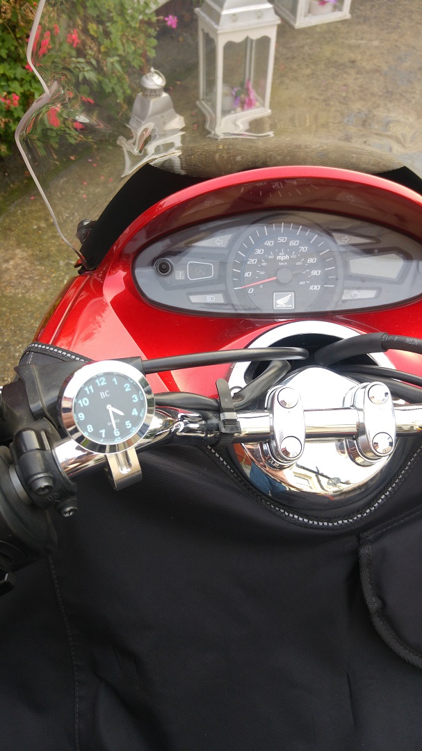

added clock as that was one of the very important things PCX was missing from factory in my opinion

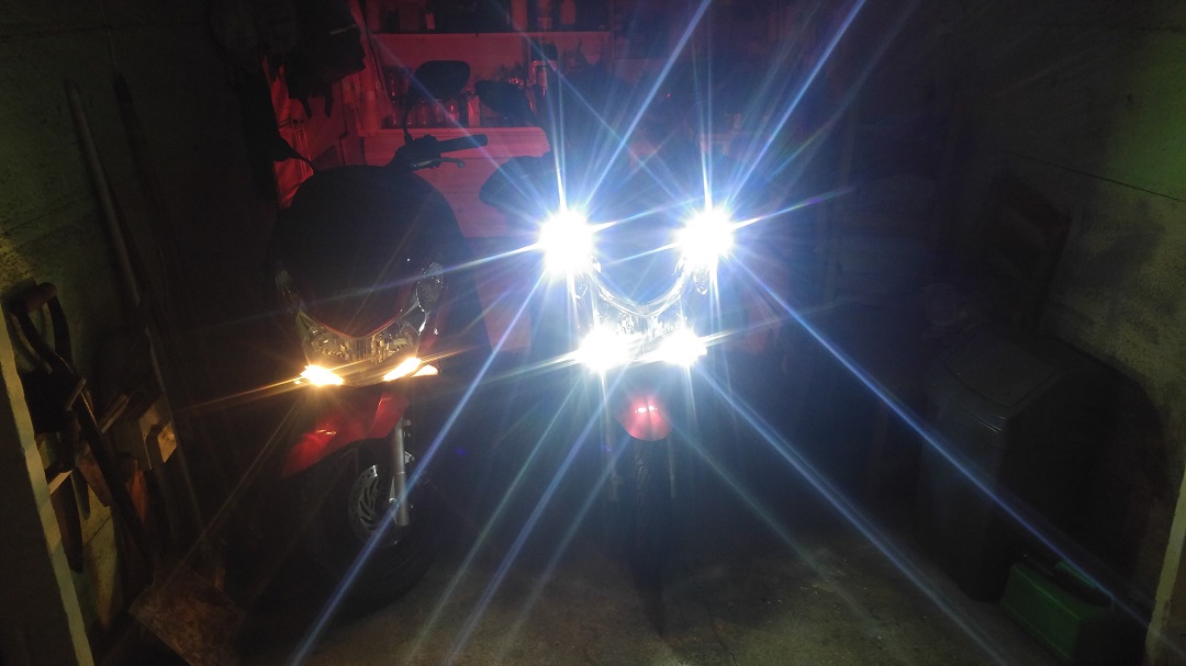

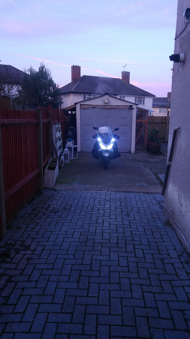

and now time for my latest mk3 LED PCX

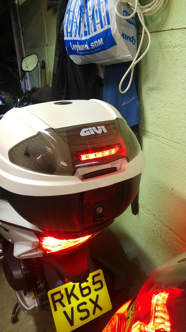

as standars for me more lights added
of course extra brake light also fitted

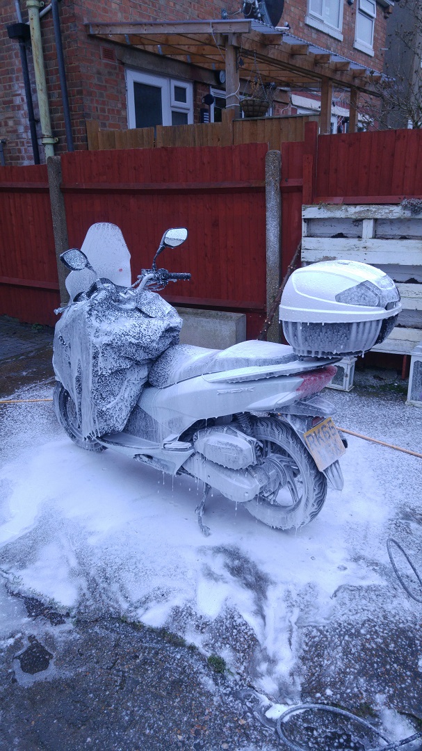

now this is how she likes to be washed

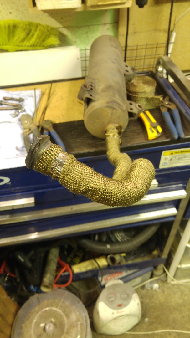

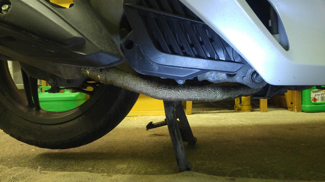

and more recently I've wrapped exhaust

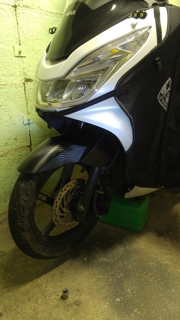

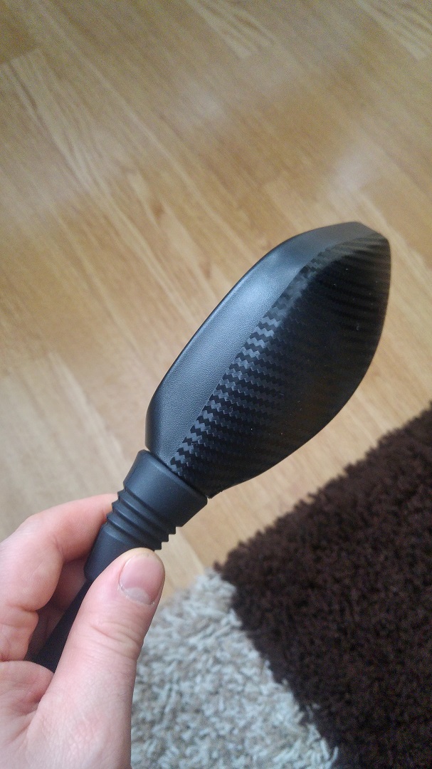

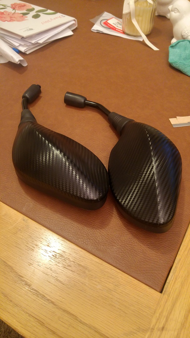

Carbon fibre on front mudguard and mirrors

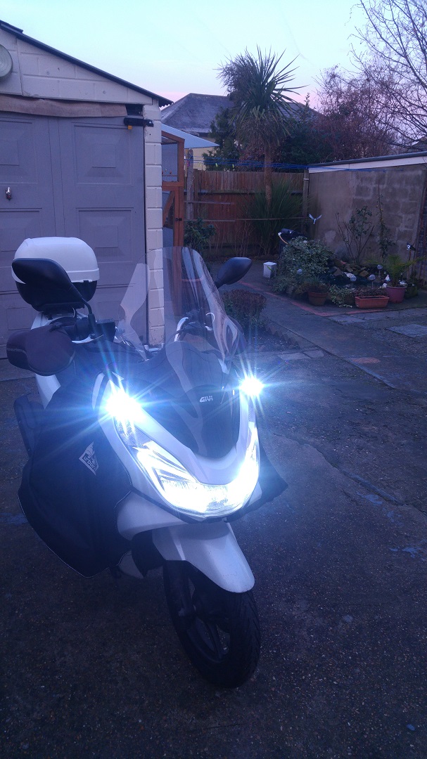

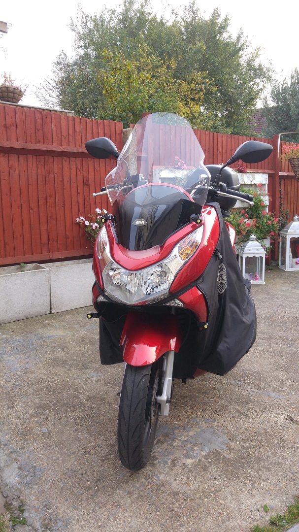

Is that a Tucano Urbano Leg Cover? Does it work good?
Cool pics. . .the lights look really effective. . . :geek:

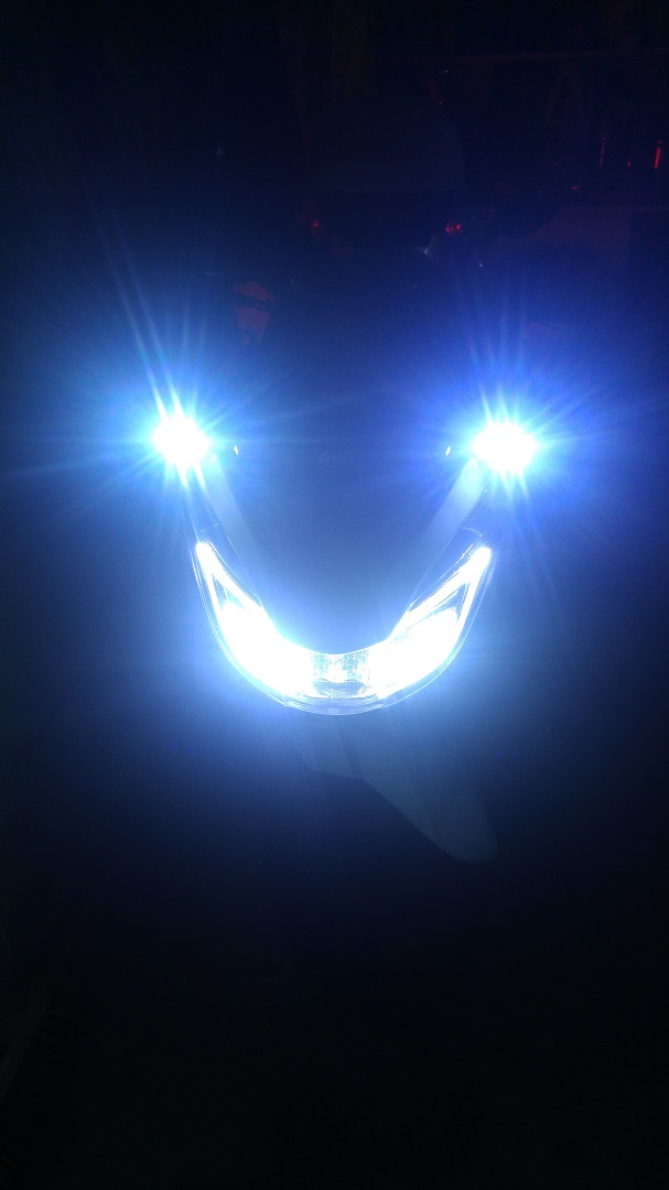

PCX150Rider wrote:Is that a Tucano Urbano Leg Cover? Does it work good?
Yes it is Tucano Urbano. It works great although I must say mk1 & 2 used to fit better. I'm getting a bit more draft on my legs but nothing major, I was still riding her in -5C.

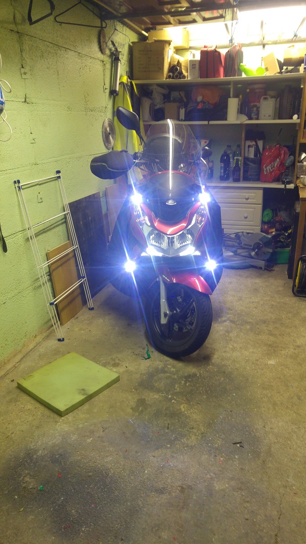

Lights are just amazing. £4 for set of two or even cheaper if you can wait month when ordering from China. I've noticed a lot of cars giving way as it simply makes my scooter look like a BIG bike.

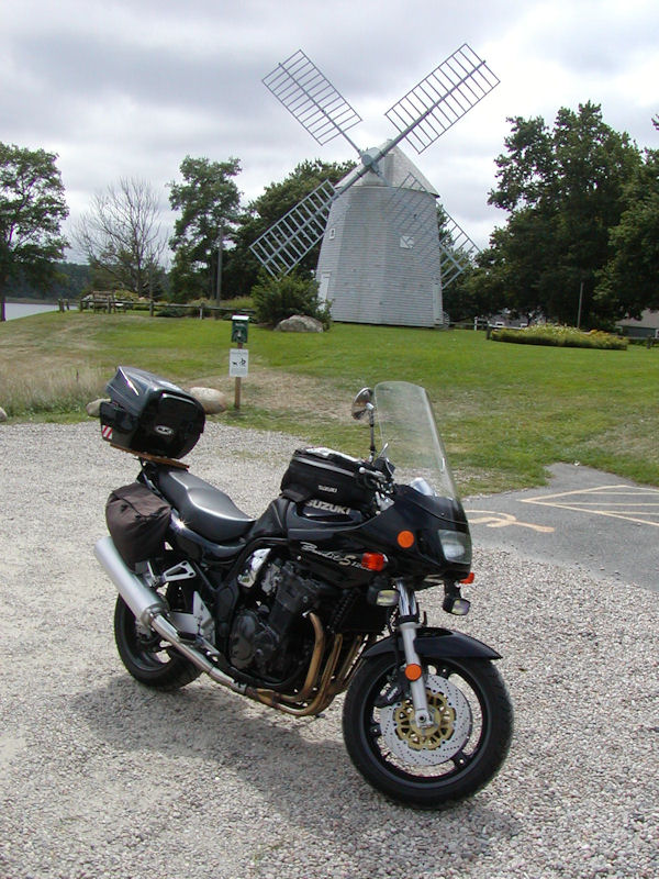

I put auxiliary lamps on my Suzuki Bandit (SAENG/TA Night-Cutters) and they not only improve the night time viewing range and intensity but also, as you imply, make you more visible and apparent. I run them day or night and I've got them aimed so they don't blind oncoming drivers. They offer different types of mounts so when I get my PCX I'm going to have to take a good look at it to see if there would be a suitable mounting surface on it. Or, I'll have to consider something else. On my Bandit I mounted them to my turn signal stalks. No problems after many years of service. That being said the PCX electrical system would have to be able to handle the load as well. LEDs draw a lot less juice. It will be an interesting aftermarket consideration for later on. . .

This is how I installed the "Night-Cutters" on my Bandit. It doesn't look like I'm going to be able to do the same thing on a new PCX. That being said I'll try to figure out if one of the other installation options would work. . .or do a little skill and drill. As I've said before I'm going to have to make sure the electrical system can handle it before I do anything. Was your LED installation a complicated ordeal? Separate on/off switches for them?

I run mine hard wired onto side lights so so seperate switches. I prefer them on all the time. This only draw 3W per light or maybe even per pair as I can't remember now.
You might have a problem trying to put normal halogen lights on new PCX electrical system, I can't see it running them.
But let me know if it does as would be handy to know.
