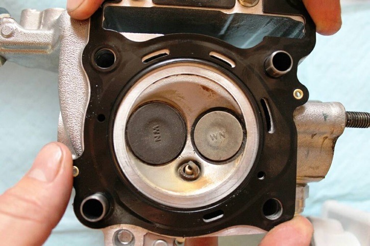

I have 164 yuminashi kit with stock exhaust and it overheats. But it overheats with aftermarket one from webike as well so it's not exhaust fault. I wish I have cut bigger holes in head gasket water ports when I put it on. Too late now. If I have to take the engine apart again I will put 150 head conversion from yuminashi.

Go ahead and get it. It's well worth the money. I have overheating problems with mine but it's head gasket alignment rather than stock exhaust fault.

Don't know. It took me two days and few beers. I'm amateur and it's taken more time to take plastics off than actual engine work. Have a go yourself and you might learn something. Great tutorial here on forum from Maddiedog. You'll be happy with the results. Image
