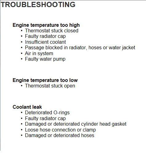

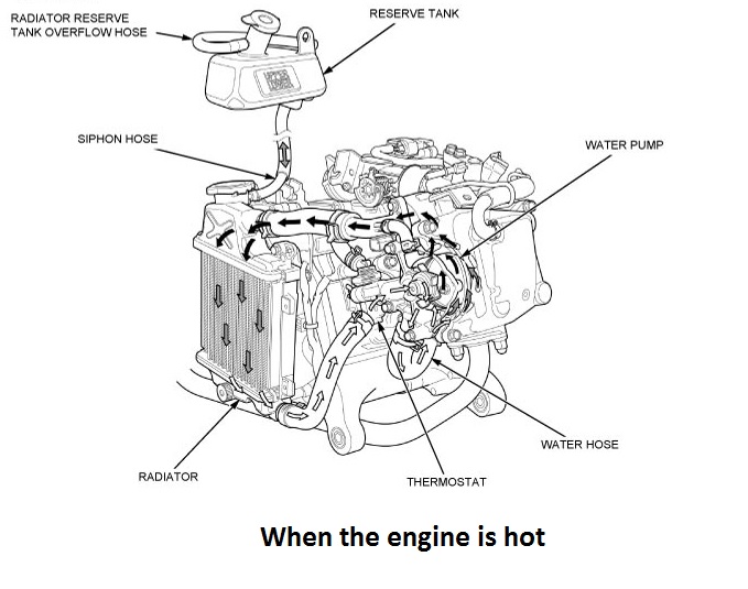

I'm glad you solved the problem.
But in my practice as a mechanic I have met thermostat issues also. Not mean PCX particularly (on PCX- never) but another vehicles Honda.
Anyway a couple words about COOLING SYSTEM...
If you have some issue with cooling system you have to check the level in radiator (while its cold) coz level in reservoir tank not always shows actuall level in main system (eng+radiator) of cooling system. Resevoir tank it's like a secondary or support system in there. The main volume of the cooling liquid stay in the engine+radiator that connects with the reservoir tank by valve in the radiator cap. When engine hot (normal temperature) the valve open for relieve extra pressure, and it go with some amount of antifrize to the reservoire tank. When engine cold the process will be reversed - for avoid extra vacuum in main system...
PCX Cooling system trouble shooting.png (16.92 KiB) Viewed 5538 times
