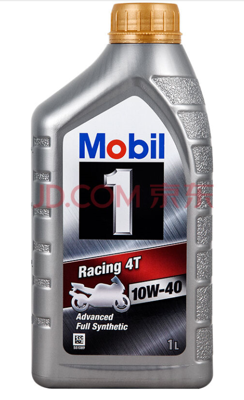

Mobil 4T, suitable for PCX?
This is MA i guess? can't see MB or MA anywhere.
Fully synthetic.
Do you gents use this or other MA engine oil?
Is it better than that recommended on manual?
I am planning for a long haul trip with my new PCX, to Tibet, then desert, then Xinjiang then back to eastern seaboard at south China.
Does this oil sustain the long trip?
Thank you, gents.

Your PCx is still new isn't it? Not a good idea to go fully synth yet, I think.

Doesn't get much better than that .

This stuff will be fine, and is more than adequate.
Honda ships it with a synthetic blend, so ignore anyone saying (incorrectly) that you need to use non-synthetic until break-in is done.

Sir, what engine oil do you use? is there a consensus on which oil is the best for PCX?maddiedog wrote:This stuff will be fine, and is more than adequate.

Seriously, after the first 1000km or break-in period, any full synthetic 5W30 or 10W30 will do.
If you want to get silly about it, the only oil I've seen clean the inside of an engine is Castrol Edge.
Is that what you want from an oil? I don't know, but it's very impressive for before and after shots.

The PCX has a dry clutch and transmission (CVT), so you do not need motorcycle oil. I use synthetic 10w30, whichever brand is cheapest name-brand. I'm using Shell Rotella T 5w40 right now, it works great. The PCX can take 10w40 fine as long as it stays above freezing, and is actually better in hot climates.doletotodole wrote: Sir, what engine oil do you use? is there a consensus on which oil is the best for PCX?
I'll reiterate chicaboo reiterating gn2: "The slippery kind works very well" -- I'd add that synthetic slippery kind in w30 or w40 is best.
