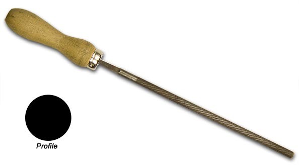

BTW..drilling is possible without a dremel, mine was done with an SDS drill! On low speed setting. Instruction sheet suggested a 17mm Drill bit, I only had a 16 and a 19mm...used the 16..way too small....even the 19mm was! I had to still shave with a file to get a good fit.

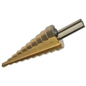

I used to drill and cut oval holes in rear wings of new Mercs when they had electric aerials. You just need a decent hole cutter and a round file.

thanks for the heads up, waiting for my cheap ass 17mm drill bit but sounds like i need to file it down a bit more.

my cheap ass drill bit didnt arrive, so requested for a refund and ordered a different one. Bought a dremel for other stuff but will use this to widen the hole when I manage to start on mine.
