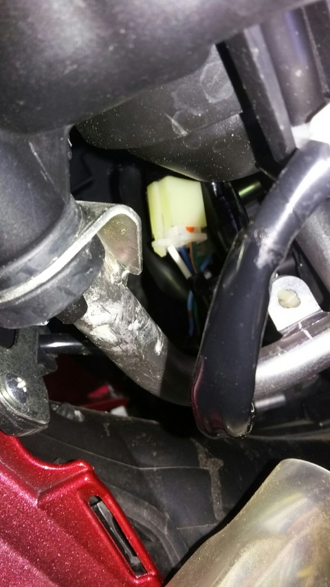

Ok, on to the project. If you shine a light up under the right front fenders, way up into the wiring , etc. you will see this plug. Be careful because there are two plugs, but only one of the has 3 wires. I think the other has 2.
Notice the prong that sticks up from the plug. That is what keeps the plug from coming apart while you ride. You will need to press that pointed tip in while pulling on the plug (I cheated and pulled the wires close to the plug as I held in the pointed tip.) You may have to wiggle the plug to get it out. That will release the plug and give you room to strip some of the black plastic encasing the wire bundle. I used my pointed wire cutters to snip the plastic, but if you have something else that you think will work that is fine. Just be careful and don't clip any wires.

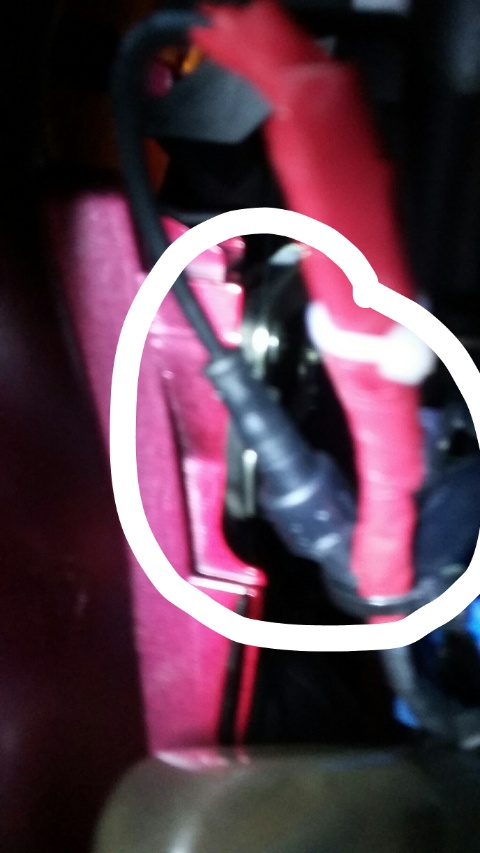

Here is the quick connect plug I used, but there are a lot of different types out. Once again, I purchased it from Amazon.
(I don't know why there are 2 copies of the picture, but at least it gets the point across.)
