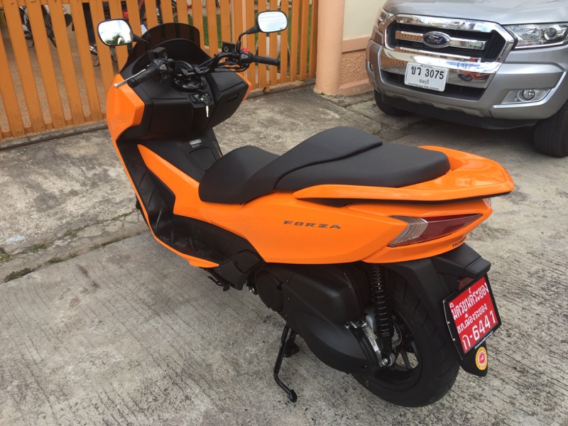

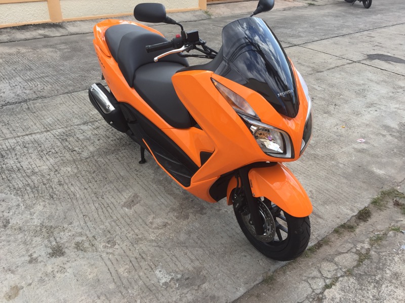

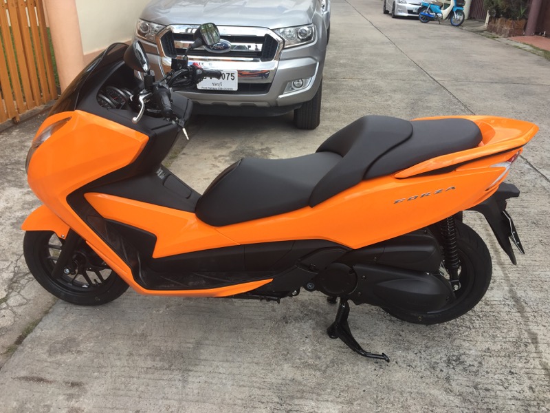

Just wanted to say hi from over here in Thailand, I've just sold my 18 month old red PCX150i and upgraded to a new 2016 Forza. Pictures of the new steed below, I've only done 200 Km so will save my thoughts about it until I have a few more Km's under my belt but my initial impression is very satisfied with my choice.

Woohoo! Orange!
NICE!
We do not have color choices for the Forza. It's RED or RED in the United States.
Congrats on the move up. Have Fun and Keep us posted on yer likes/dislikes
Oh, and double check your profile, it's time for an "happy" update
Re: Hello from Thailand
Looks good in orange

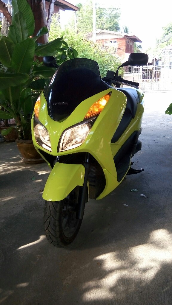

You forgot Lemon Ice YellowLinnets wrote:
We have 4 colour choices over here in Thailand for the 2016 model, Gloss White, Matt Black, Metallic Blue and Orange. Personally I would have liked Metallic Red with Gold wheels the same as my PCX but it's not an option.

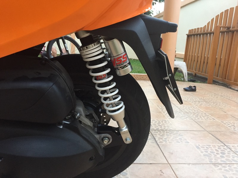

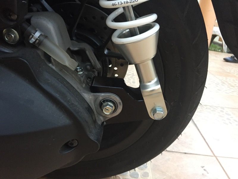

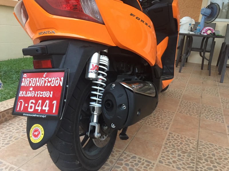

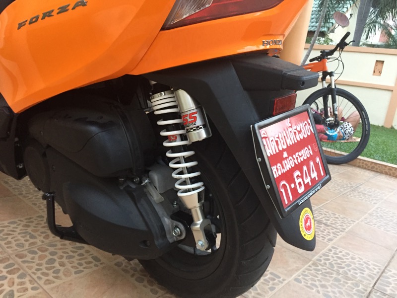

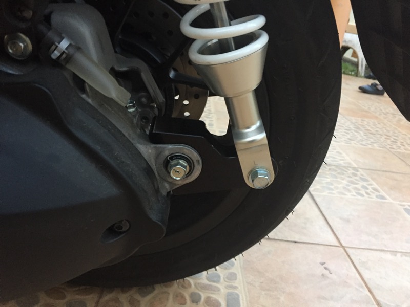

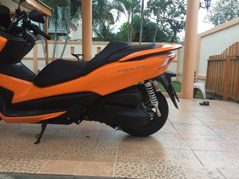

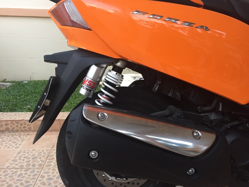

So as I alluded to in my previous post I decided to do something about the rear suspension on the Forza so off i went to my local scooter tuning store and purchased some YSS piggyback reservoir shocks part No.TC302-400T-04O @ 6200 baht ($175) and a set of milled alloy extenders/height reducers @ 2500 baht ($70).
The idea behind the extenders is that you move the bottom mounting point of the shock absorber rearwards by about 60mm which for the same length shock reduces ride height and increases the trail of the rear suspension and very much improves the ride quality. I was persuaded to do this by the guys in my local shop who really seem to know their stuff and have been tuning Forzas since they were first introduced. They have also suggested that the front end can also be improved by fitting YSS valve cartridges into the front legs, might get that done later.
Removal and installation took me about 30 minutes with a 14mm combination spanner and a 14mm socket, extension bar and ratchet. Unlike the PCX no plastic panel removal needed as the top bolts can be accessed easily enough.
I set the spring preload so that there is a 20mm gap between the adjusting collar and the top casting and I've only tested it for a few Km's but I can tell already that the ride whilst still being firm is much more compliant and comfortable over uneven road surfaces than stock.
Also its much easier to reach the ground with the reduced ride height and in my opinion the increased trail improves the looks of the bike too, I've always thought the Forza stock upright position of the shocks looks naff.
Anyway this post is not much use without pictures so here goes.

I presume that is US dollars. I like the shocks but they would be substantially more in Canada. I hate my front end.

Oooo Linnets I like those rear shock extenders. I would like a set. Can you give me a link to the manufacturer or dealer?

Wow you just solved a big mystery for me! I had seen that bracket over at a bikerzbits store. I couldn't make heads or tails of how it mounted. I figured I'd lower my forza at some point and figure it out then.
Here's a link to the one I saw.
https://bikerzbits.co.th/forza-lowering-bracket.html
How much did it reduce ride height? I was thinking of going a little lower than that but I'm sure it would cost way over the 2900thb of that part.

Those are the same Lowering brackets, just a different colour anodizing...It actually only lowers the front seat height by 1/2-3/4" but when you only have a 30" inside leg measurement every little helps lol.Andreas wrote:Wow you just solved a big mystery for me! I had seen that bracket over at a bikerzbits store. I couldn't make heads or tails of how it mounted. I figured I'd lower my forza at some point and figure it out then.

Thanks for the pics and link, Andreas and Linnets. I'm going to buy a set from Bikerzbits as soon as we get the shipping figured out. According to their website, they're having a problem shipping to the US now. I sent a "contact us" message to them and I'm waiting to hear from them.
