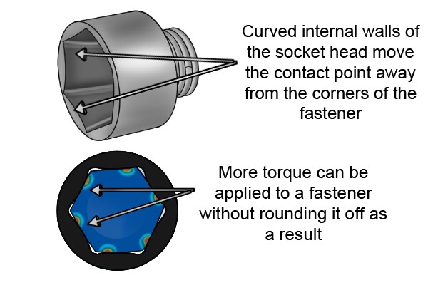

If you get an impact wrench/gun, you will need hardened steel impact sockets (they're usually black).
Even chrome vanadium steel 1/2" sockets are too soft and will chew out around the drive bit on an impact wrench.
If going by hand, quality 3/8" drive sockets will go a long way and do the 44ftlbs on the variator nut (unless you get Chinese pig steel...).
I use a cheap 3/8>1/2" drive adapter for that one huge 39mm socket you need for the clutch, and it works fine for me.
Don't cheap out and buy 12 point sockets, they chew up nuts and bolts like no one's business, and they're more likely crack and slip.

These sockets aren't the best in my experience. (I'm a mechanic to trade)
Full hex sockets are the ones you want. They don't slip, especially if your getting budget ones like multi hex sockets might do.

Six pt sockets are the best , but for driveline work on the PCX 44 lbs and 39LBS of torque are not any big deal. Any good chrome Vanadium will do just fine. I use air impact wrench and chrome without any issues. However, if you are torqueing 80-100 ft lbs auto lugs nuts or engine cylinder heads then go get the impact sockets and heavy duty 6 pt. design like the mechanics say above.
