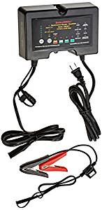

After using a BatteryTender I found it prolongs battery life, but they still die when I feel they shouldn't...from an Engineering standpoint.
Problem is the BatteryTender doesn't remove the sulfur buildup from the plates, and it could keep too high or too low a float charge depending on temperature.
The BatteryMINDer 128CEC1 Battery Charger is designed around airplane battery usage, and therefore much more tightly regulated. They charge with pulsed DC at 3,600Hz, which is a harmonic that pops the sulfur buildup off, and also adjusts the float voltage based on temperature. The only other charger that used to do that was the BatteryGenius, but they removed that ability as a cost-savings measure. The BatteryMinder was able to bring back 3 batteries the BatteryTender let fail, so it paid for itself considering the other batteries on it that shouldn't go bad (it does up to six car batteries at once, after that the pulsed DC gets filtered too much and doesn't have the needed strength to desulfate the batteries).
BatteryMINDer 128CEC1 Battery Charger $150 on Amazon
