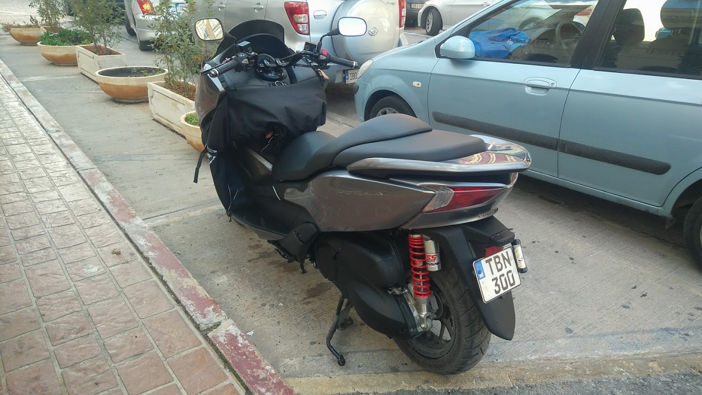

So i got the YSS shocks, and installed them, and to me, i feel a huge difference is the comfort of the suspension.
The shocks are still on the factory preload, and it does ride a bit hard/stiff, how ever it never bottoms out. the orginal shocks always gave me a sharp jolt as it bottomed out, and crashed about.
the yss are loads better, when riding solo, and with a pillion!
Definitely a upgrade i would recommend to anyone
below is a pic of the upgrade as a thread without photos is worthless
Also on the bike i have the tucano leg cover (rolled up) and the bikerbitz handle bar ends and brake leavers just for a bit of eye candy
next on the list is a custom seat, just to give me a few more inches of legroom, as i am a bit of a tight fit on it
