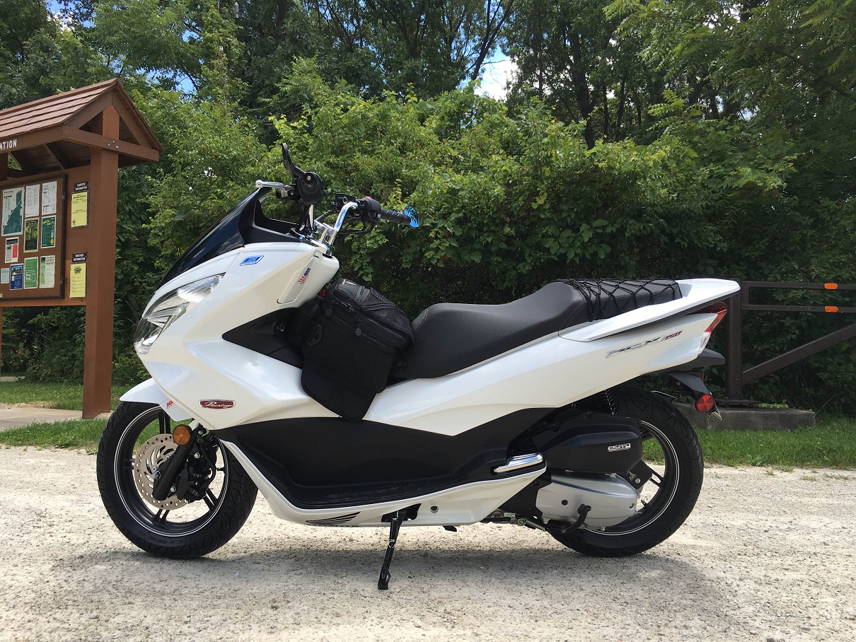

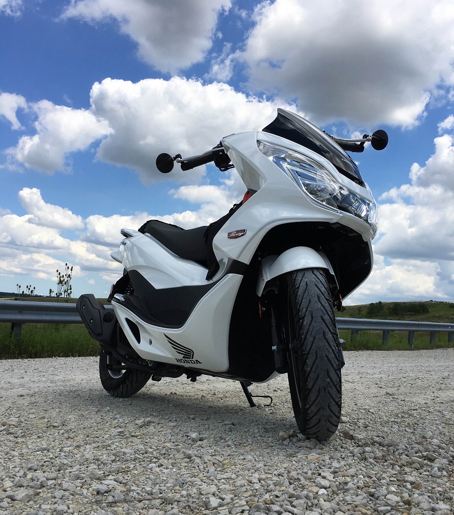

Of all the scooters we have featured in here I quickly go down a list when I see a new one posted.
1. is it a Honda... if not move on
2. is it a step through... don't like em
3. are the wheels at least 14"... anything less is a pot hole hazard in Chicago town
4. hows the mpg
5. does it have a dedicated forum following
6. good luck with seating position... most will suck for long rides
yes performance parts and kits are available, do your research here and you will find the truth about each one.
And finally what else looks this good... strike the pose 8)
