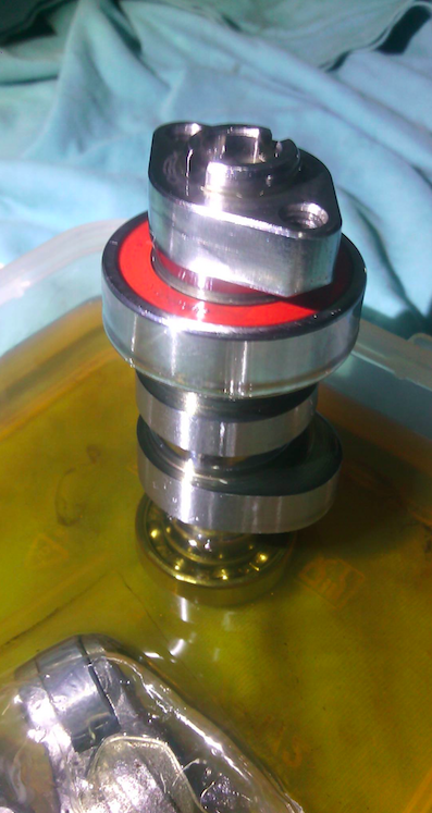

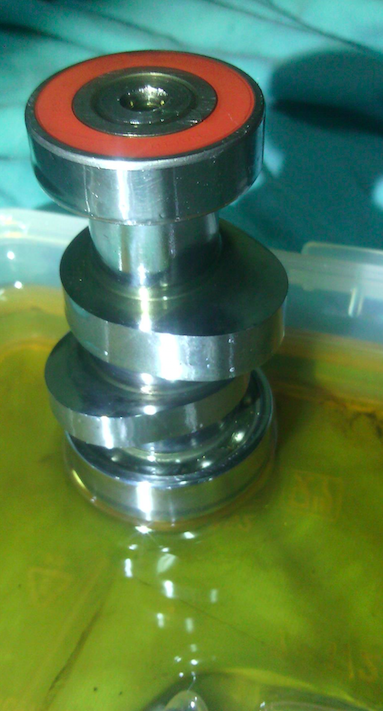

Not related, just want to share pictures of my camshaft, cnc ground by a shop over here. I just make them, I admire the beauty of a precise product.

That's one sexy cam!

chicaboo wrote:That's one sexy cam!
Sometimes I think I got a metal fetish. That camshaft just sits quietly on my table, I spent 50$ just to have one copy for show. I like my cam smooth and curvy :lol: :lol:
Regarding the ticking noise. I figured that using 0.05mm and 0.08mm on a yuminashi camshaft makes it quiet and you must know when to set it in a camshaft travel (not condescending or anything, just want to make myself clear), it's not spinning the radiator and set like a normal cam, you must feel the rocker arm begin to open, something like that.
Not quiet like stock. Nothing is quiet like stock :lol: . But I knew my Yuminashi camshaft was less noisy compared to my friend's Takegawa one. And you're correct that the valves are slammed back a bit harder. That's why I always buy new valves to use with a new engine and ask a shop to do a valve job. Helps keep a nice compression.

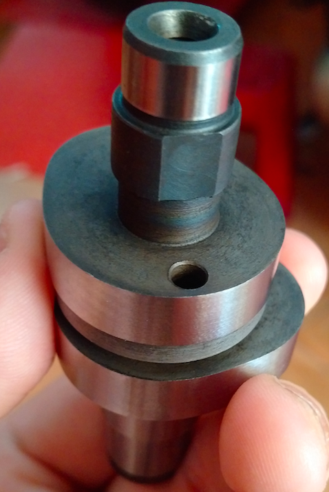

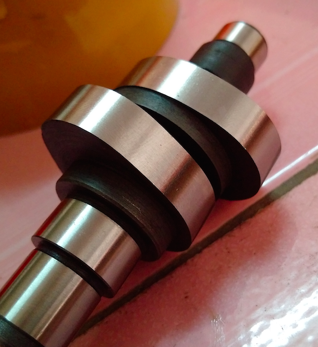

Just to make you guys curious, here's some more pictures of my baby.
Screen Shot 2016-09-22 at 9.27.49.png (660.64 KiB) Viewed 8000 times
Isn't she sexy, damn those curves can kill any man :lol: :lol: :lol: .
CNC ground from cast iron blanks. Or steel, it's too long ago.

It is a thing of beauty!

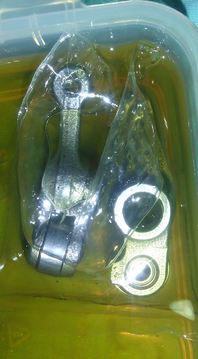

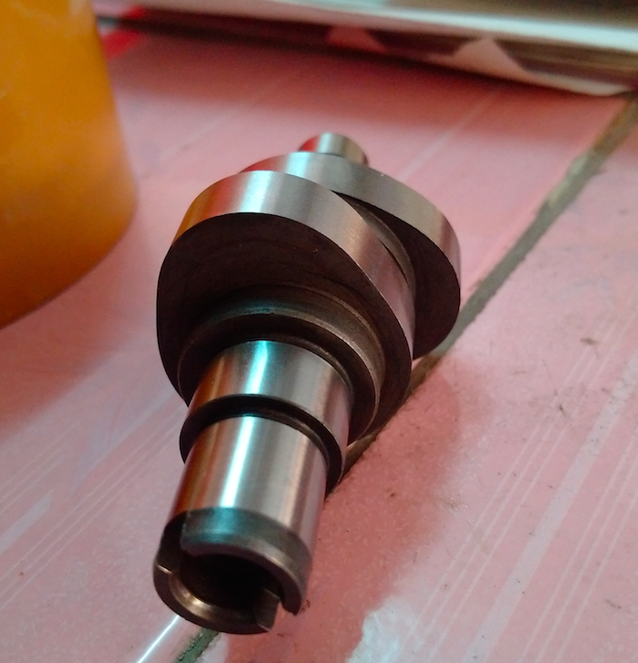

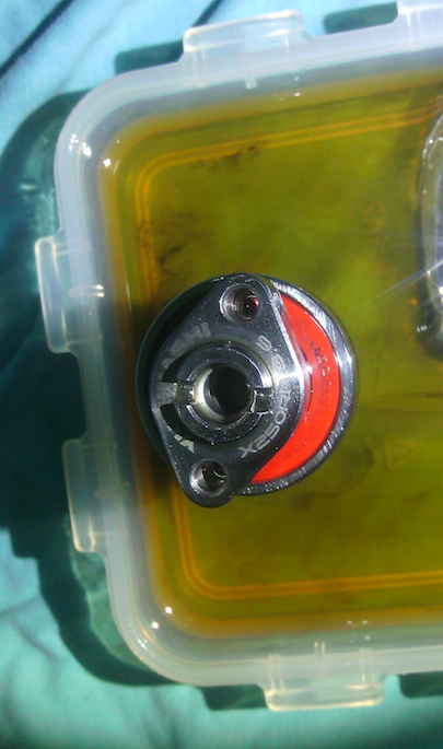

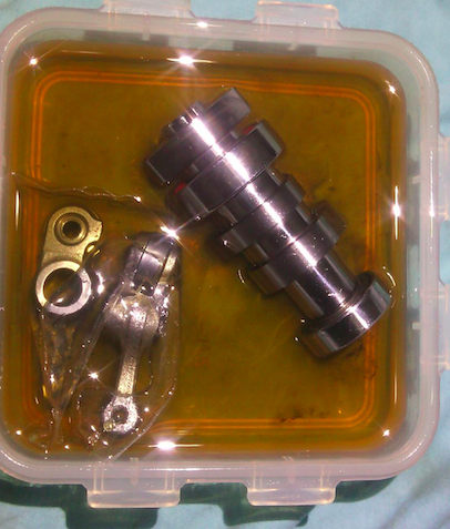

She's sexy right? But sometimes when she's asleep, I sneak out to meet this lady here. This one is a naughtily dirty one, she likes to bath in 10W30 fully synthetic oil. So I give her just that. :lol:

Did I mention that she loved to bring her 2 friends? :P
