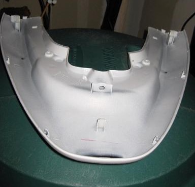

Cracksta, we're all in the same boat here...hit or miss with the plastics. Sorry about your miss, it would make me :x too. Upside of this? You can do a practice "drill" run on the cracker and be a pro on the newbie :D
I've had several panels off my scoot the past few weeks including "this" one. I took some underside pictures of them for my future reference. Sharing this now for anyone wanting to see the grab rails's underside.
Good luck with the new panel and install!
