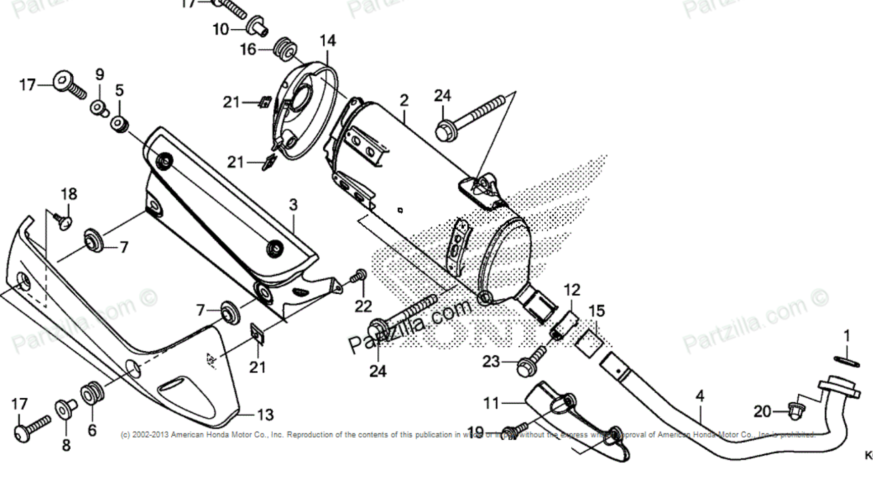

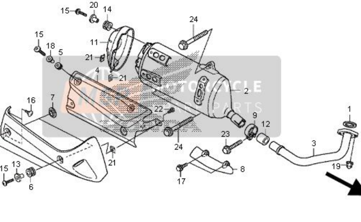

You will see the diagram of the exhaust system for 2 different Honda bikes. Now I understand how and why certain places sell an exhaust overseas that is made for another Honda scoot.
It might not be 100% identical but who knows it might be because these are only sketches in a parts catalog.

Well the 1st pic is the SH300 and the 2nd pic is the Forza300 : )
I have also looked all over ebay(all countries too) looking at and comparing the used exhaust, and comparing the bends of the exhaust pipe.... if they are not exact then they are VERY close.

The slip-on part looks the same (muffler and heat shield), but the header pipes look different to me.
So if you're looking at an aftermarket exhaust for the SH300 hoping it'll fit the Forza, you might still be out of luck.

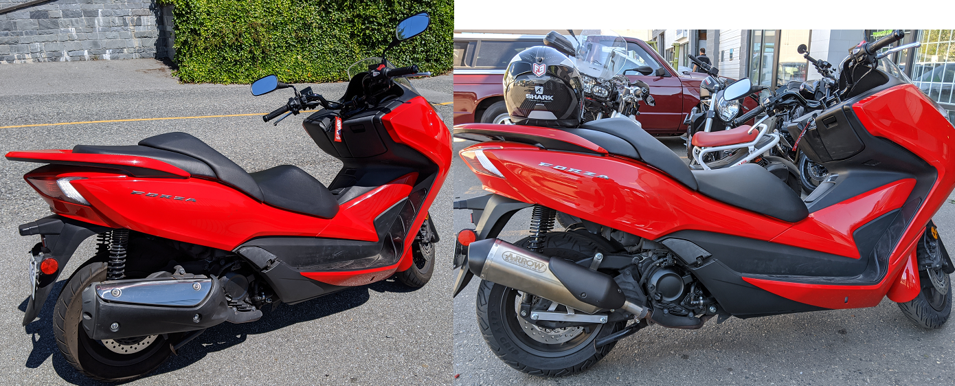

Today I took the Forza to get it's arrow slip on fitted to it.
Went to a fellow Honda Enthusiast who works at a machine shop in my area(Frankenstein Speed & Custom) and got a custom bracket and mid pipe fabricated to make it fit to the stock header. I'll be looking to ceramic coat in black everything but the slip on to clean it up even more.
I'll take more pics of the bracket when i take it apart and also measure the weight difference between the old and new.
Here's what it looks like: before and after picture.
- exhaust_StockVSNew.png (1.88 MiB) Viewed 44911 times

Re: Forza aftermarket exhaust
Maybe also send a sound recording, I guess that was the main reason for the change...!
It was more for looks and then weight; sound wise it's just a little deeper cause i kept the dbkiller in.
I'm still able to stealthily speed around everywhere so its good.

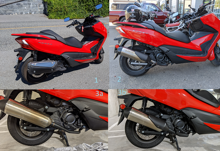

Finally got the header mid pipe and brackets ceramic coated black. Matches quite well with the stock black.
Looks 100% stock.
Put a bigger pic of the new setup
Looks 100% stock.
- clean.jpg (257.87 KiB) Viewed 44623 times
- finalProgress.png (824.04 KiB) Viewed 44623 times
