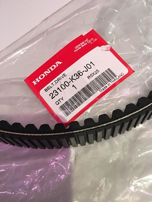

NCY kit makes another happy customer 8) buy this belt for future application, don't know if its better yet but it's the latest cogged belt design for your PCX. I will be going in at 5k to inspect wear on the NCY kit and perhaps try this belt out noting the changes in performance.
PCX belt.jpg (50.82 KiB) Viewed 15277 times

homie wrote:Now you are cooking with gas BABY! it's the cats meow... the bomb! WOOT!
Ok enough of that,
LOL! Thanks for the tip! I am very curious about your belt wear. Be sure to post about it! How many miles do you have on it now?
