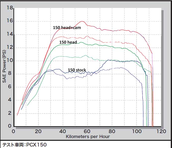

I have worked my magic in PhotoShop (it is a great achievement, as the last time I used Photoshop was in the last century) and overlayed the dyno graphs of the Takegawa 170cc kits.
One set is with the 125 head, TB etc, and the other one is with the 150 head. otherwise seemingly the same.
Blue line = stock engine, Green = big bore kit, Red lines big bore kit+fi-con, cam, and exhaust.
The 150 based config seems to have about 2hp advantage over the 125 based kit. Given the fact that the Takegawa kit does not change the TB and intake manifold, and it is also 6cc larger disparagement than the Yuminashi kit - the difference might be smaller, but it is still significant.

Thanks for the reminder. seemingly I did not pay enough attention that the size was out of the allowed range.
Here are the dyno charts. Mind that these are all rear wheel hp figures, and look for the relative differences rather than the exact numbers.
So while your's with the nice flat power curve around 13-14hp correlates with the full takegawa kit with the 125 head, there seems to be another two hp everywhere in the power curve to be gained with the 150 head.
What I'm saying that with the extra power and longer gearing one can achieve higher top speed even without raising the rev limit.
