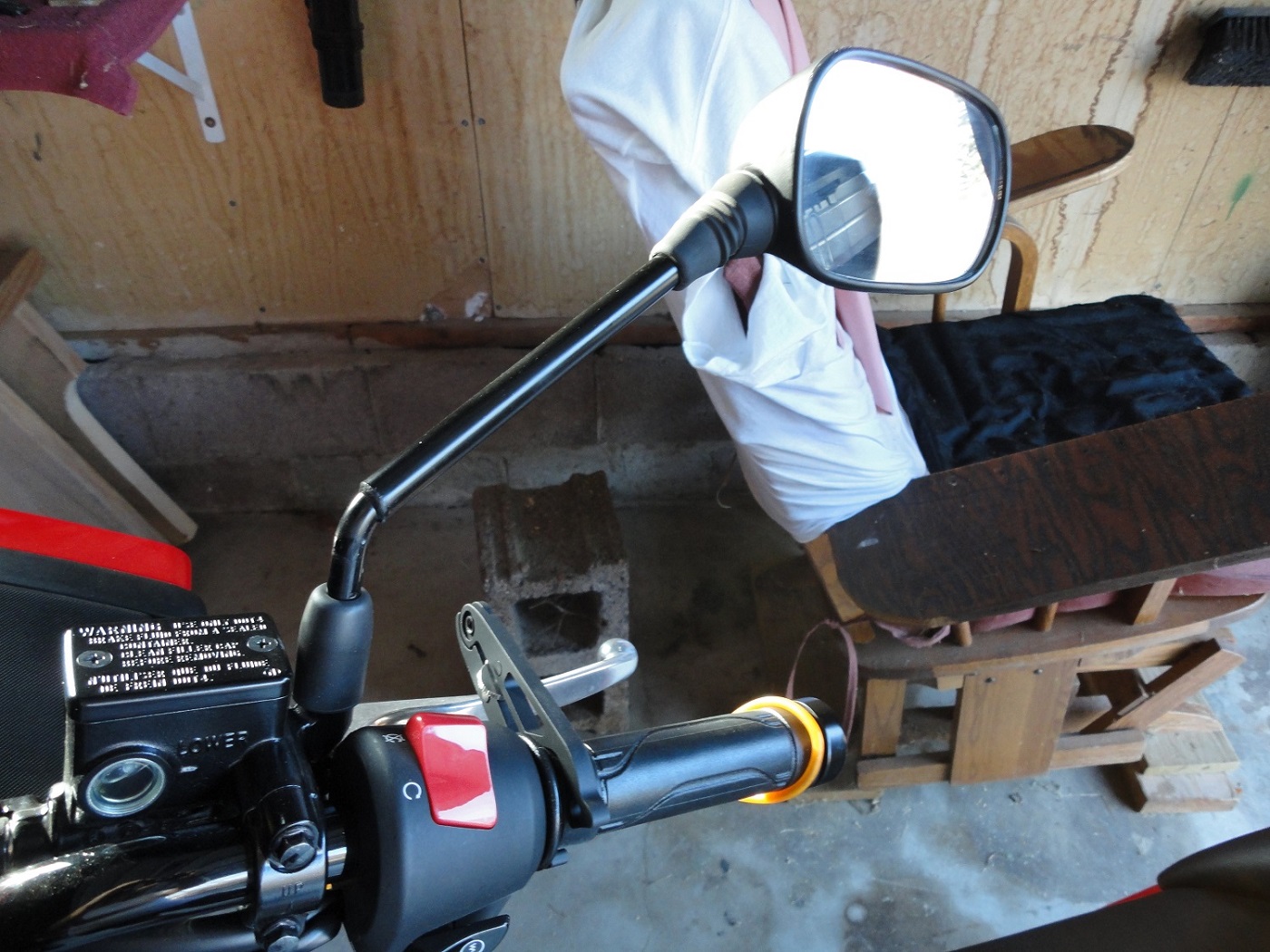

I made my own mirror extenders by cutting the steel mirror pipes, adding 6" aluminum ID 3/8" pipe, apply epoxy and paint it black. cost me 1 hour labor and $8.00 USC.
