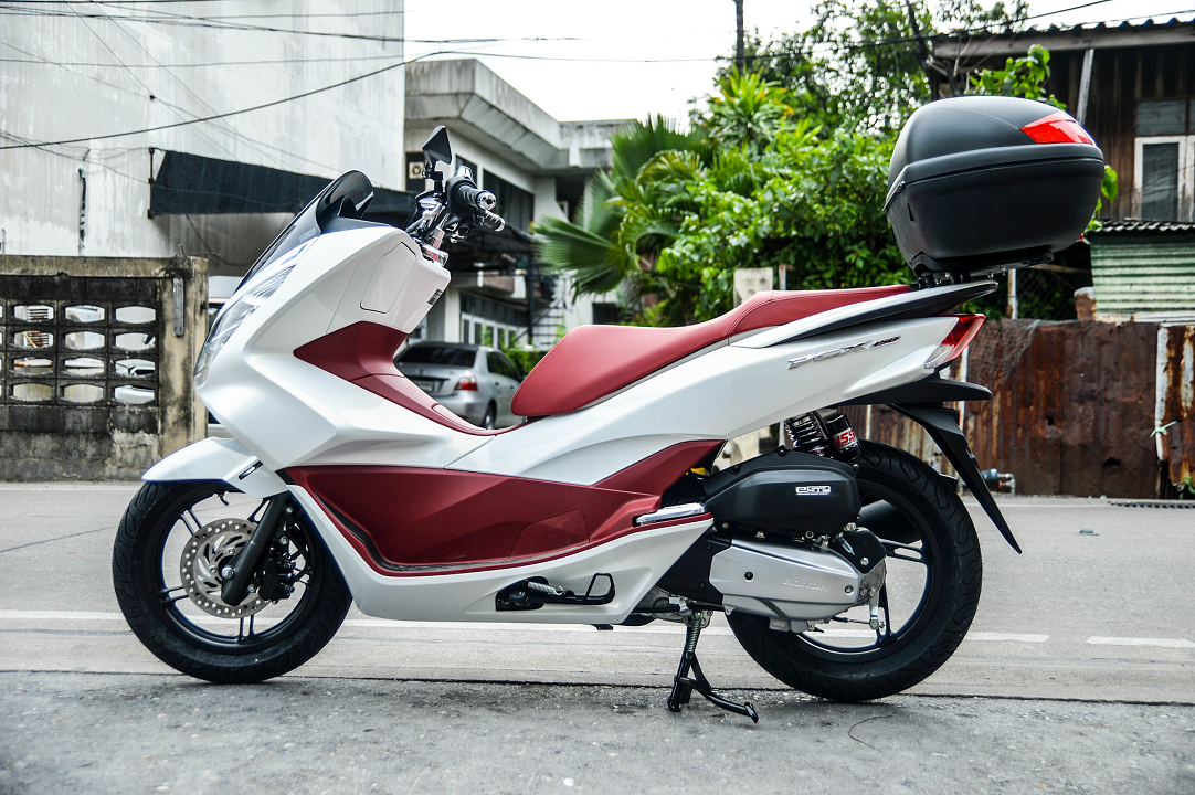

I actually bought the fatty tires but instead a 140/70-14 for the rear. On seeing them for myself I had some misgivings, the distance between the tire beads was vastly wider than the rims they were going to fit. Several members had done the mod on the forum so I decided to go ahead, off to the tire fitter I went. On seeing them he adamantly refused to fit them, that was it for me, he basically reafirrmed my own thoughts. The sidewalls would be pinched in to a degree that the profile would be changed adding to the height and narrowing the look not to mention unwanted potential handling and safety issues. Add to that more unsprung weight, potentially more drag and altered gearing. Did I mention the mainstand? If you look at the pic of this modded bike both tires are on the ground, mathmatically there's only an 8mm increase in tire height between the stock rear and the 140/70, so what happened to the 25mm gap between the rear and the ground unless the profile had been changed due to pinching from a too narrow rim? I'm going with a 110/80 rear and a regular sized front city grip due to these observations.
- pcx yss.png (1.57 MiB) Viewed 13982 times

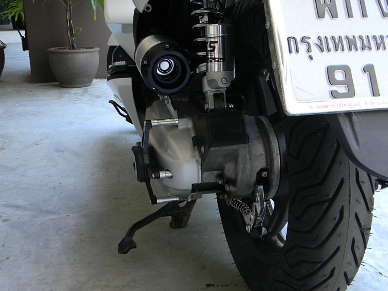

Re: 140/60/14 For The Rear
This is as good as I can do for a picture from the rear that I have on file. I can possibly get another one later. BTW .... it is a 140/70-14k2apache6.0 wrote:I've been looking to get the Arashi filter pod myself without much luck.kramnala58 wrote:"Mine is a 2010 (Thailand) and I had not problem with the side clearance, although I put a pod filter on it at the same time".dasshreddar wrote:OP 140/60 has not been done, but i'm sure you would like it.

Regarding the tire/tyre pinching in (losing width) when mounted on the OEM rim, I do not observe any loss of width, but don't have a pair of calipers to measure it accurately. But even if I could measure it accurately, I suppose to prove there was pinching, it would have to be measured when it is deflated, or better still, inflated, but on a wider non OEM rim.
If you would like a pic from directly behind, let me know and I will take one.
