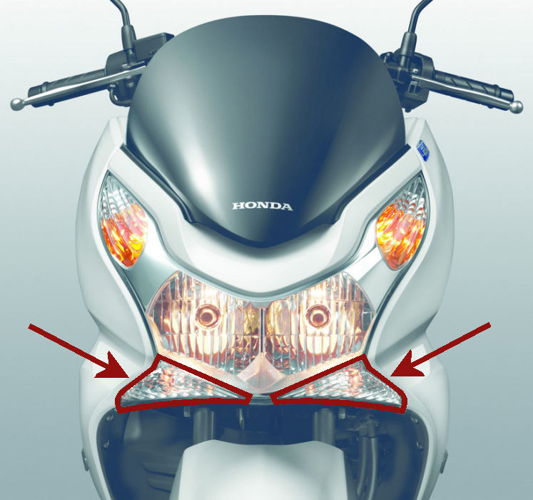

Having said that, my specific inquiry is: Are the leads/wiring stubs for the daytime running lights that are in non-US bikes present? For those who are visually inclined, image of the headlight unit with the location of these lights marked: (Fig 1)
If those leads are present, but not connected to anything, since the US version does not have sockets in these locations, then everything is good, and I can just create new connections to plug into those leads. This is where I might need to buy a pack of connectors.
If not, then I have no idea what I'm going to hook up the DRL and Running Lights to. I suppose I could connect to the regular headlamp leads, but I don't know what kind of electrical values those leads have, nor what size wires they are, if they're non-standard (as compared to the rest of the wires) which I would think they are, since those bulbs are higher wattage than all the rest of the lights. That means to me (correct me if I am wrong) that they carry more juice, and therefore should be thicker wire. Right?

Fig. 1. Location of non-US DRL

I can't believe that 20 people have looked at this thing, and not one person knows whether there are leads for the position lights in the US wiring harness, as opposed to the European/Asian harness.
Re: 2013 PCX Front Wiring Harness - Revisited
As far as I know they are not on the wiring harness for the U.S. version. When I had the bike apart I did not see any spare socket to add more wiring harnesses. It may be that the additionAL harnesses plug into the main circuit connector.There are 5 pins on the speedometer plug that are not used on the U.S. model, and the ECM module plug has 12 unused pins. There are also 3 blank pins to the headlight circuit. My guess would be that they old normally connect there, but then you have to have another harness from that point. I would have to have the wiring diagram for a British version before I could tell you for sure whether you could tape in easily or not.
Also, the white wire is for the low beam. It is the only white wire in the entire diagram. I am thinking that the green/orange wire must be part of the ground for it since all of the grounds are green or have green in them.
