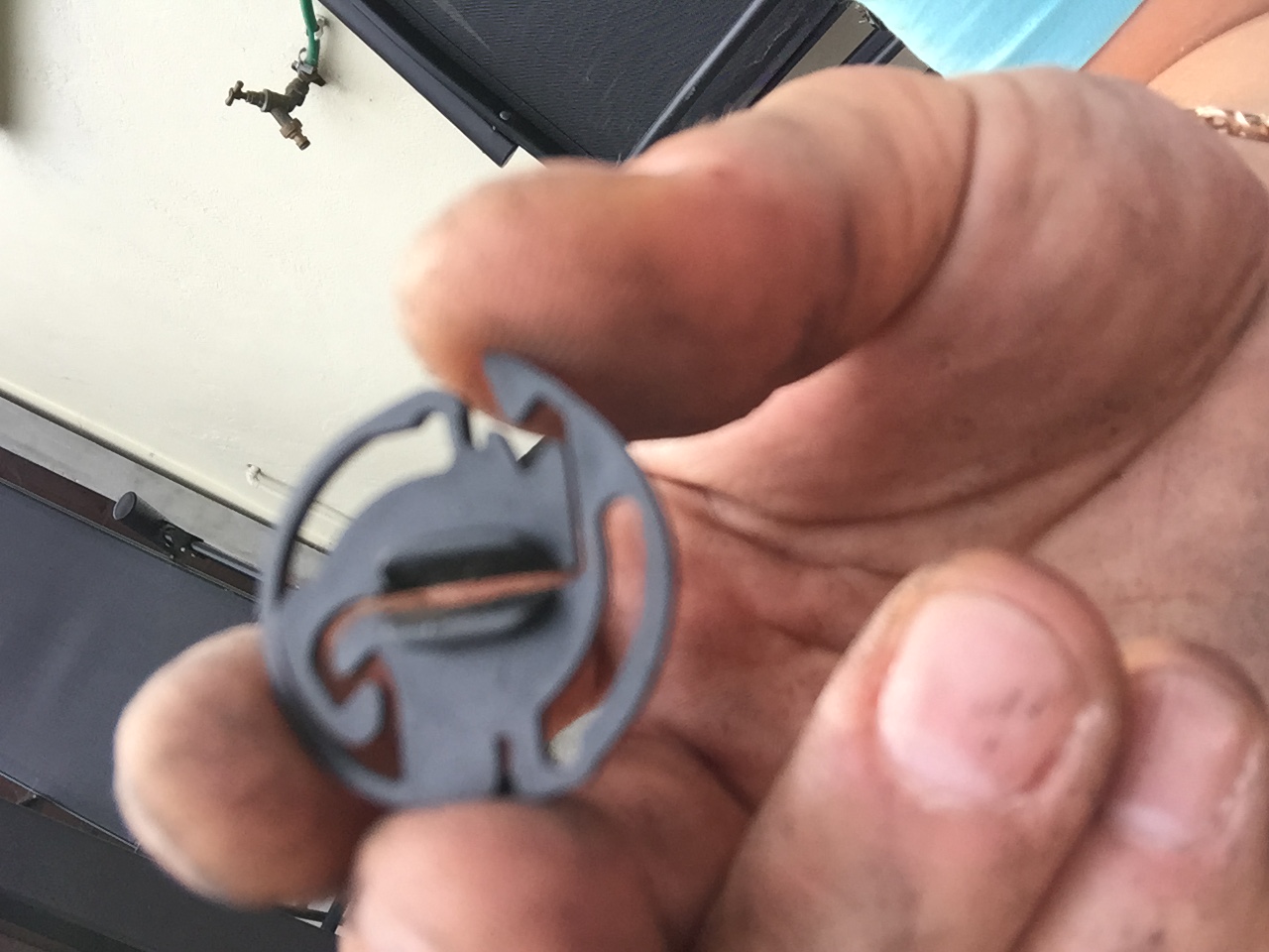

and bouz maybe someone knows where from this fixing is?:)
Re: honda pcx 125 valve adjustment help
Yes sounds good... how many miles?
That's not part of my 2015 PCX
