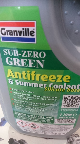

Evening all,
Not being mechanically minded and after wading through different information, could someone advise if this stuff is ok for topping up my coolant level if not perhaps point me in the right direction for the correct stuff?

I believe no, PCX and aluminium engines do not like silicate based coolant. Search google for pcx coolant, find's loads of ref's on this forum (oftne easier than using the search which does not like short words)

Yes, the Honda coolant will be fine, but pricey. Any non-silicate coolant will do.

https://www.amazon.co.uk/Castrol-178456 ... ol+coolant
The one a Honda dealer sells for use with the PCX and available everywhere for about £9.

glycol ethylene or propylene low silicate antifreeze
pretty common stuff
just stay away from dex-cool -oat coolants
might not mix
keywords are gylcol low silicate
