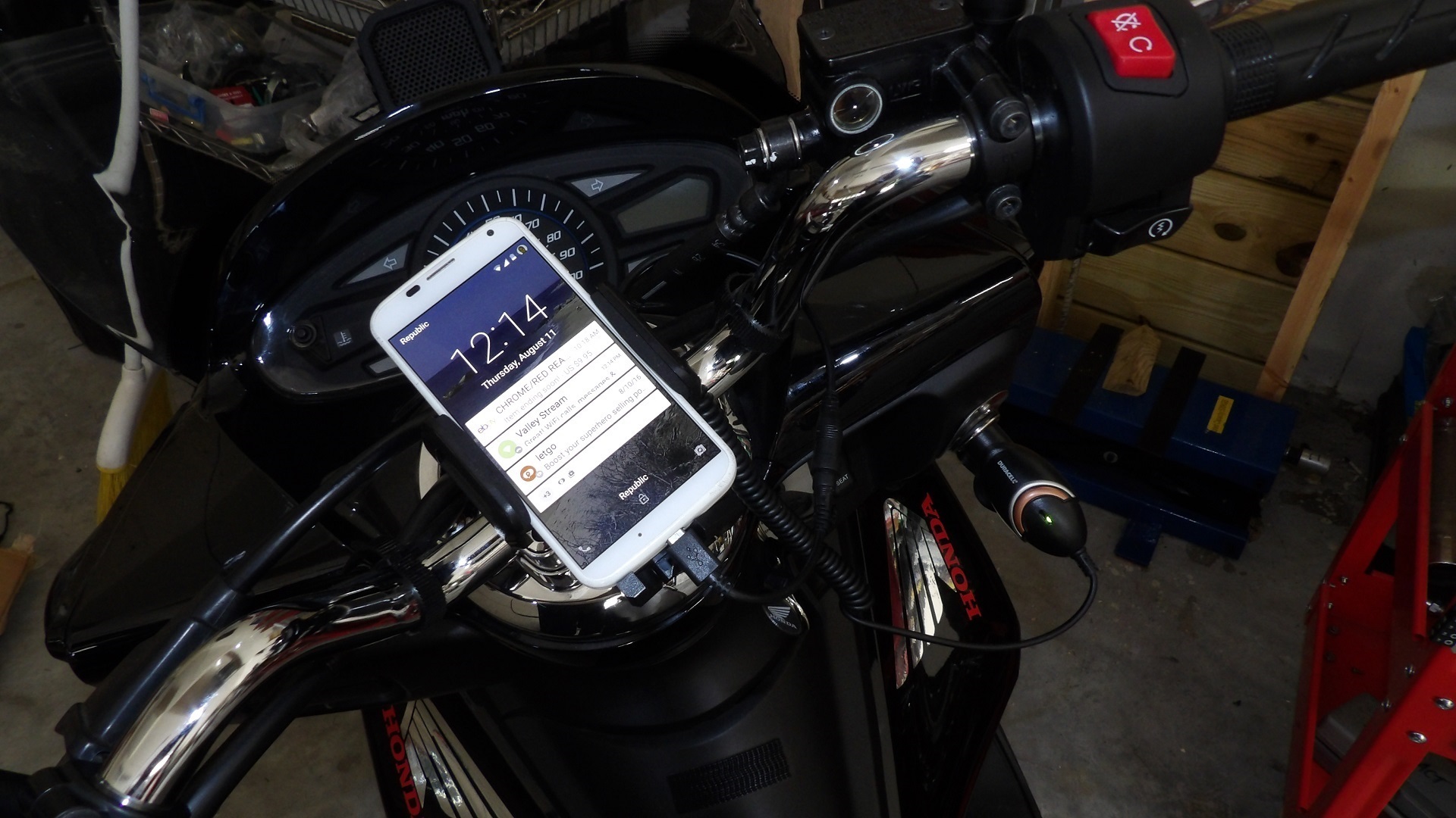

Posted: Thu Aug 11, 2016 10:18 am
I don't have a Forza. Nor do I have one of the new PCXs that have the accessory outlet in the glove box. However, I do have one PCX (my wife's bike) that has no accessory outlet, but a need to have some way for her to charge her phone. She has the Battery Tender leads attached to her battery, so I purchased a USB adapter that plugs into it, and I ran a USB cable through the seat hinge and up to where I had the phone in a RAM mount. I kept the cable out of the way by putting a piece of tape on it to use as a tab, and closed the tab in the glove box, after running the cable through the handle bar to allow it to move around when the handle bar moved.
