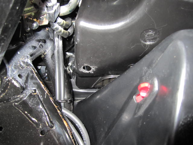

The picture is of the underside of glove box.
So dergav, I assume you drilled your hole on the left (outer) side of the bottom of the glove box. In that case, the hole would be above the underlying faring/fender. You then ran the wire between the glove box & the fender around & up to the opening at the center of the handlebar. The fender provides splash protection for the hole opening. Optionally the hole could be drilled into the "single layer" box from under the bike on the right side of the box bottom, but there is no fender there to provide splash protection.
I want to contemplate this some more. I'm not sure I want to leave the wire in place because I only use the GPS occasionally. I wasn't aware that the Garmin unit (I assume a Zumo), provided power at its mount connection. I might want to explore that option too.
- IMG_2309-25pc.jpg (119.17 KiB) Viewed 10269 times

Correct...Google the garmin zumo 340LM and you will see the style of fitment...I only use the satnav occasionally but leave all the wiring and fitment in place...would be a bit of a faff to remove the wiring all the time..the ”weakness“ is that the fitment could be easily cut and nicked..unless you adapted with a joining piece at the handlebar. I had intended doing that but have not to date.

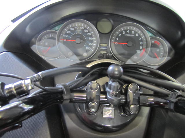

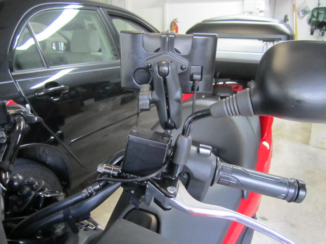

I finally did this. (I was away on vacation for a couple of weeks).
I did it similarly to dergav except:
- instead of running an accessory outlet, I ran the Garmin 2597LMT OEM charger/cable from the glove box up through the hole in the center area of the handlebars.
- The hole location is more toward the center/rear/bottom of the box. That is because I couldn't angle my drill bit at the location specified by dergav and I wanted to keep the running of the wire away from the more forward moving parts.
- To weather protect the 1/2 inch hole I ran strips of duct tape across the hole, both inside and outside the glove box.
- I need to weather protect the usb connector which is exposed on the handlebar area. I'll use a small plastic bag until I can find something better.
- IMG_2324.JPG (59.17 KiB) Viewed 10120 times
- IMG_2323.JPG (59.59 KiB) Viewed 10120 times
- IMG_2322.JPG (61.43 KiB) Viewed 10120 times
- IMG_2321.JPG (59.55 KiB) Viewed 10120 times
- IMG_2320.JPG (62.79 KiB) Viewed 10120 times
- IMG_2319.JPG (62.33 KiB) Viewed 10120 times
