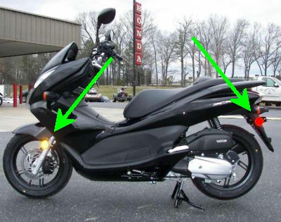

The first thing I'm doing is mounting a set of running lights in the place of the reflectors on the front and rear of Natasha. (Photo 1)

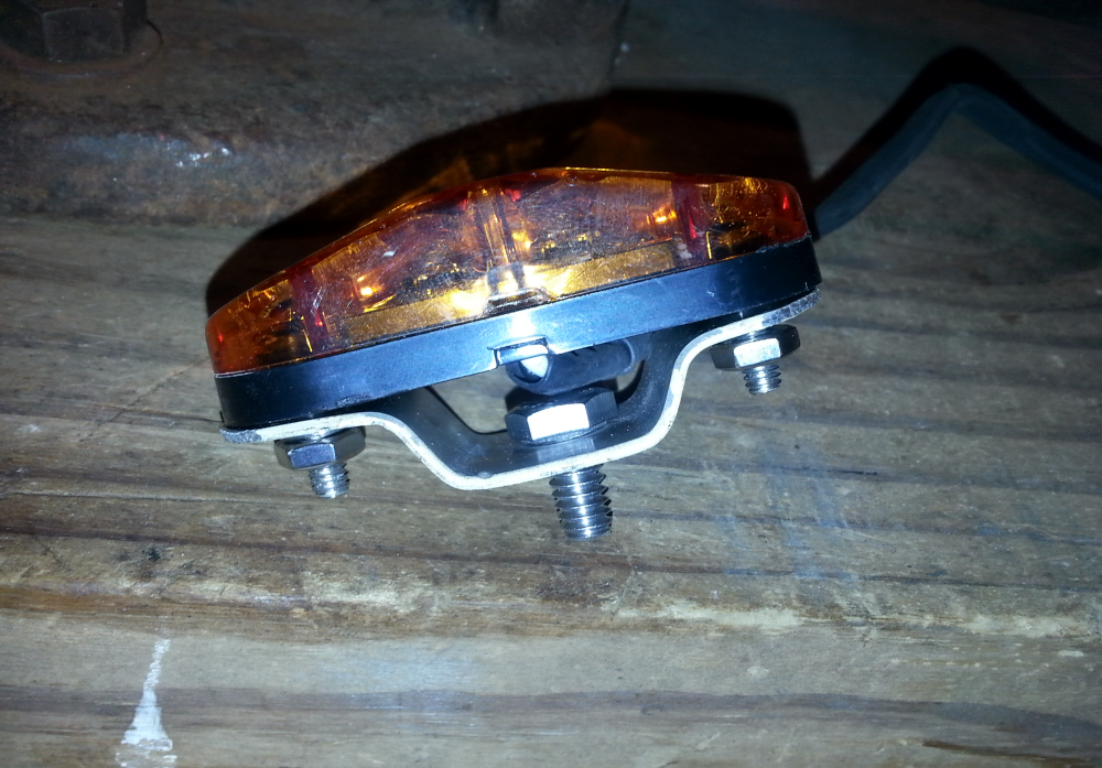

The running lights look like these, and they put out a fair bit of light for their size. (Photo 2)

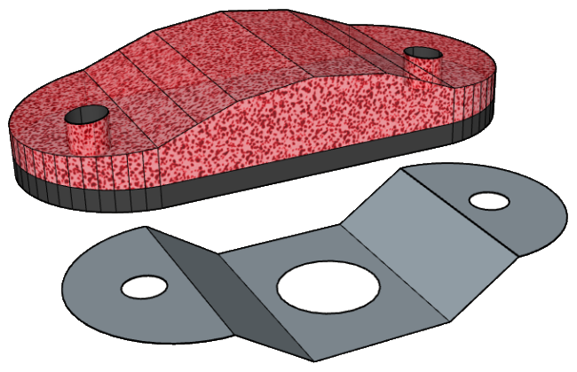

What I couldn't do is mount them directly. There is a single hole where the round reflectors mount, and there are two smaller holes on the running lights. So, I needed to have some kind of bracket to mate the two together.
The design I came up with had two flat parts to which the lights could mount, and a recessed center section to be mounted where the reflector goes. (Photo 3)
This is the part where I had absolutely no clue what I was doing, or how I wanted/needed to do it. A search of the net for an appropriate bracket turned up nothing suitable, so my mind went to work.

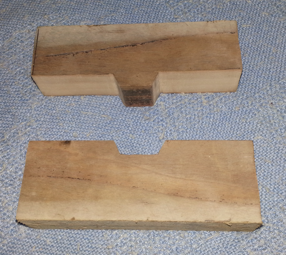

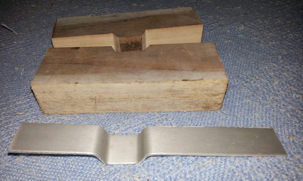

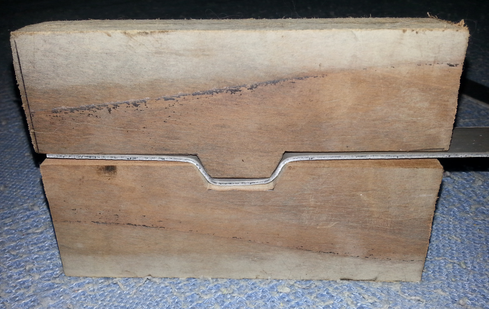

Thinking about how I was going to make the brackets with these strips, gave me the idea of cutting up a block of maple wood I happened to have, and I was talking to a neighbor yesterday about my inability to find any woodworkers in the area. He said he had a bandsaw and router table, and if I wanted to use them I could. So, I took my maple pieces over there today, cut them to the shape I needed, and voila! Press blocks. Total cost to me: 1 six-pack of his favorite suds.
The press blocks look like this (Photo 4)

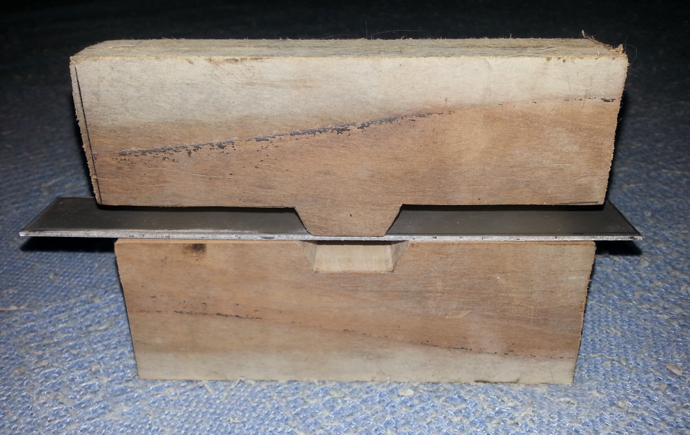

Here is how the process works (Photos 5 - 7)
Again, total cost to me, 1 six-pack of beer.
And now I have my brackets, which will only need a bit of shaping on the grinding wheel, the proper sized holes drilled in the proper positions, a coat of spray enamel and the running lights are ready to mount.

Photo 7. Bracket shaped.
Photo 6. Squeezed in vise.

Photo 4. Press Blocks.
Photo 3. Bracket design
Photo 2 Running lights
Photo 1. Reflector location

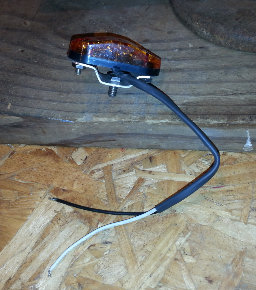

I've finished the brackets project, and I have to say, they turned out exactly the way I had envisioned.
Here are a couple of photos to show what the new running lights with bracket, look like.
