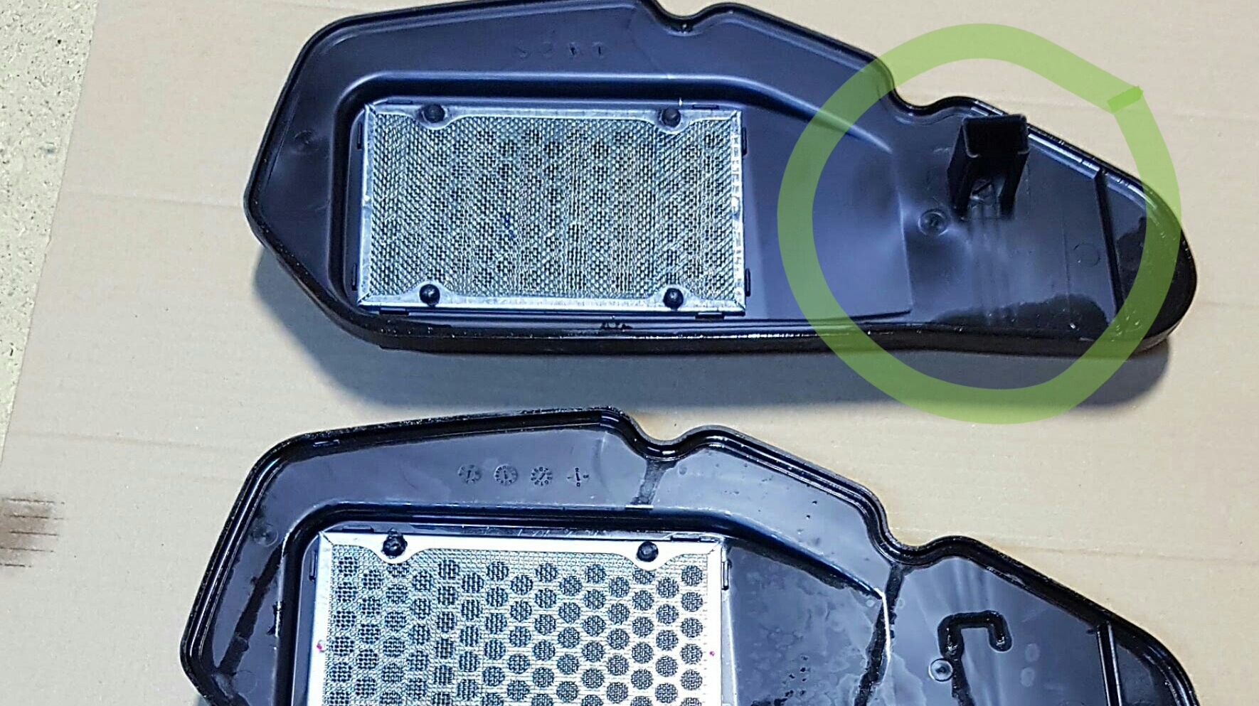

Is the esp '13 filter the same as used on the '14 led models? Most sites suggest the older '13 filters are not compatible?

I compared '12 150, '13 125 '15 125 and SIMOTA eSp filters side-by side (long story, i have an extra 150 complete airbox to be used with the big bore kit install) There is one small difference on the back of the 15 filter (i guess ro avoid a certain resonating spot on the plastic part if the filter, but all are interchangeable with each other without modification.
Will post up pictures once I get to a computer, but I'm positive that all esp models can use the same filter.

Thanks! From pictures I could find it was hard to spot differences and I need to order one at some point, but the part No: and sites suggested '13's were not compatible and '15's were not for sale (I guess I checked too soon into '15 release and it was silly to stock them). As you say it may be the tiniest change.Oyabun wrote:I compared '12 150, '13 125 '15 125 and SIMOTA eSp filters side-by side (long story, i have an extra 150 complete airbox to be used with the big bore kit install) There is one small difference on the back of the 15 filter (i guess ro avoid a certain resonating spot on the plastic part if the filter, but all are interchangeable with each other without modification.

The difference marked with green on the picture.iceman wrote:Thanks! From pictures I could find it was hard to spot differences and I need to order one at some point, but the part No: and sites suggested '13's were not compatible and '15's were not for sale (I guess I checked too soon into '15 release and it was silly to stock them). As you say it may be the tiniest change.Oyabun wrote:I compared '12 150, '13 125 '15 125 and SIMOTA eSp filters side-by side (long story, i have an extra 150 complete airbox to be used with the big bore kit install) There is one small difference on the back of the 15 filter (i guess ro avoid a certain resonating spot on the plastic part if the filter, but all are interchangeable with each other without modification.
