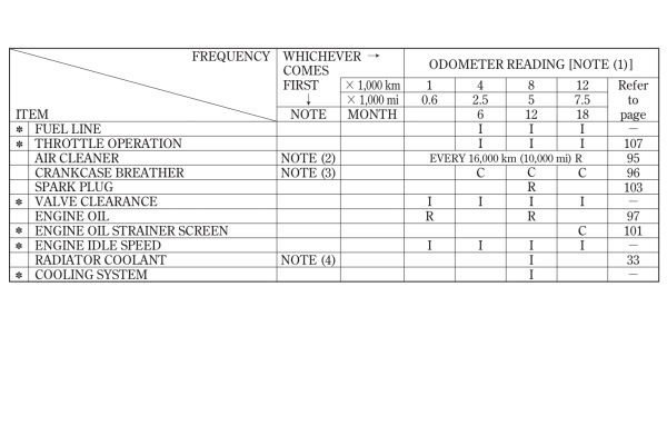

Hello! I am the proud owner of a 2015 Honda pcx 150, it only has 50 kms and i have a few questions ...

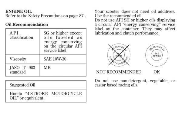

Due i live in southamerica (Perú) and the temperatures are between 13 degrees in winter and 30 degrees in summer, and humidity is very high, what type of oil should i use, i was thinking 10w40 full sintetic, is that ok?

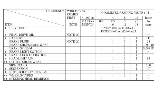

Another thing i notice is that the oil change intervals are every 2000 kms according of my dealer, is ok?
I also want to know the change intervals of
Air filter, coolant liquid, spark plug, brakes.
My previous scooter was an Honda too, a carburater 125 elite, when i first took a ride on my pcx i didnt knew how powerfull it was so i think i over rev a little the throttle, but just that once, is this little mistake going to affect in any sense my pcx? I do not pass 50 km/h when cruising, i know is have to be very gentle the first 500 kms because is a new bike.

Welcome to PCX ownership. It is indeed an impressive machine.
As for your questions, the service intervals are in your service manual, as are the specifications for oil.
Oil specs
Oil specs
