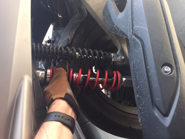

- Mmmmmm, new rubber and springy bits...

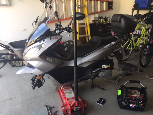

- Hover Bike!

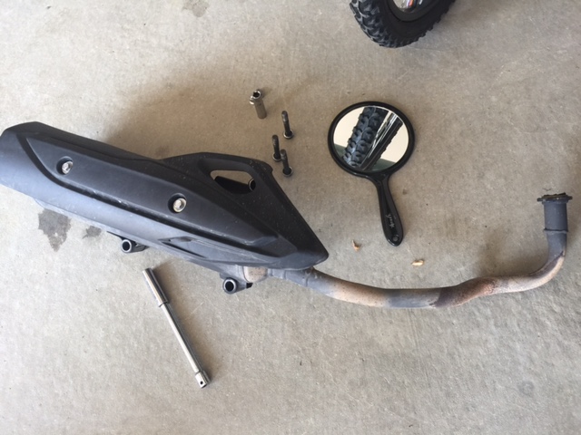

- Mirror is REALLY helpful getting this bad-boy back into place...

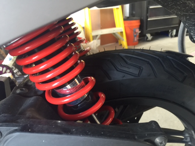

- Red is just plain faster (and yes, I had the bike hanging from the ceiling...no, not really...)

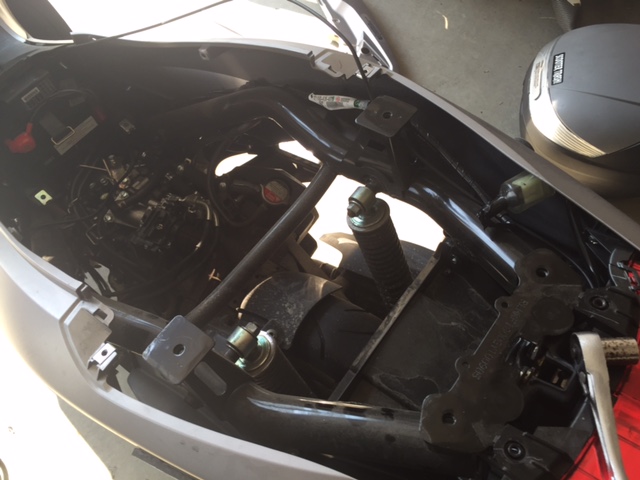

- I don't need no stinkin' pet carrier!
