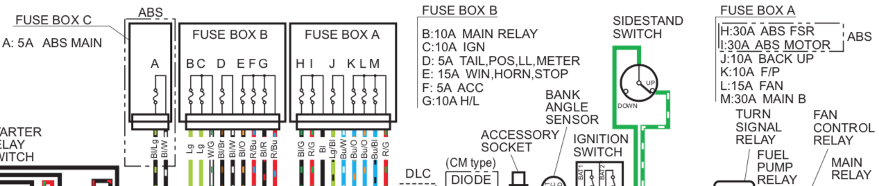

Well, here's a start on fuse location. This is a clipping from the wiring diagram in my shop manual (US Model NSS300/A 2014-2015). N.b. that it refers to fuse boxes A, B, and C, but the owners manual refers to fuse boxes 1, 2, & 3. Very helpful, Honda.
If the ACC slot is under the right side of the dashboard, then I assume that the Fuel Pump (F/P) slot is down next to the battery.

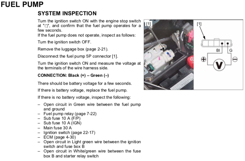

BTW, the shop manual isn't very forthcoming about fuse location apart from this one little bit of the wiring diagram. For instance, here are the initial diagnostics for checking the fuel pump (assuming, I suppose, one hasn't heard it pressurize when turning the key on):
Screen Shot 2018-09-18 at 7.55.06 PM.png (183.15 KiB) Viewed 11750 times
There's no warning that Sub fuse 10 A (F/P) and Sub fuse 10 A (IGN) are in different locations on the bike.

All of this is true, but none of it tells people to which fuse box they should look first when they know which system they are diagnosing. Go into the battery area? Go under the dash? Which one has the fuse for the farkle-puffing system? (or whatever) That would be very useful knowledge to have, especially if one is on the side of the road somewhere.
