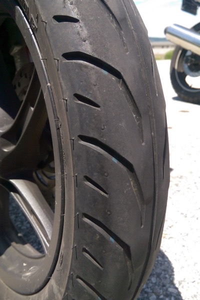

So, I run my scoot about 5 miles every day across the Susquehanna River on US30. I occasionally run it longer than that at highway speeds. Took a look at my front tire this morning and it is seriously cupped. The pic doesn't do it justice. This is the stock Dunlop at about 7250 miles. I've got a city grip on order, but there you go; riding at highway speeds with the stock Dunlops isn't recommended.

I'm not sure what I'm supposed to be looking at...?
All I can see in the foreground is a normal front tyre and there's no cups anywhere.
Cups usually either have tea or tits in them.
Re: Holy cupping Batman!
An undesirable irregular tread wear condition. I have Dunflops on my Buell and I watch for this too. Next tires will be something different.
None of that in the picture either.homie wrote:An undesirable irregular tread wear condition.

I doubt that the quality or type of the tire has anything to do with it. Your next tire will go the same way unless you get at the real problem. Make sure you keep enough air in the tires, neither too much or too little--this makes a big difference in how tires wear. Maybe the tire was not balanced properly or has gotten out of balance somehow?

Balance seems unlikely. They seem fine at high speeds. I keep good air pressure in them, and check it at least weekly. PA roads are horrible though. Showed my instructor and he seemed to think that was the major culprit, that and running the scoot at higher speeds than it's really meant for.flyingzonker wrote:I doubt that the quality or type of the tire has anything to do with it. Your next tire will go the same way unless you get at the real problem. Make sure you keep enough air in the tires, neither too much or too little--this makes a big difference in how tires wear. Maybe the tire was not balanced properly or has gotten out of balance somehow?

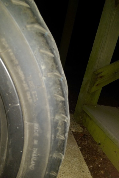

Here's a close up. The lump on the right side (your left) toward the upper center of the pic, and the curling of the left side tread (your right) should be more visible.gn2 wrote:None of that in the picture either.homie wrote:An undesirable irregular tread wear condition.

Would help if I added the pic

Hmm. My scoot is going in for 6000 miles service Thursday. I'll ask them to look at the tires and do so myself. I spend at least 20 miles/week at max speed. Plenty of 45-50mph, too. Some roads are very rough here, and I seem to seek them out. Rear tire is definitely showing wear. 432 new miles over the weekend.
It's fine it's just squared off and wearing the tread.
At 7 K miles on the front tire it is about time to change it anyway. Most front tires don't make it much beyond 7,000 miles before needing replacement. Rear tires will go twice that distance.

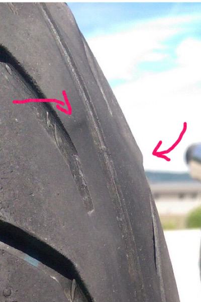

Yup, I got cupped tires once because I didn't keep the inflation to spec
The arrows point to the edges of the cups (they're like facets)

The area in Homie's picture which the yellow arrow is pointing at just looks like a section between two sipes and I can't for the life of me see what the problem there is supposed to be.
To me the dark line in the centre of Dailyrider's picture which the pink arrow is pointing at doesn't look like a problem either.
Front tyres on a scooter last three or more rears in my experience, so shouldn't need changing till 15,000 at the earliest.

WOW GN... I would have thought you to have this sorted and I haven't even looked up the facts yet. This cupping which I have seen on car tires (not bikes) by sheer physical existence (not even knowing if low inflation is the culprit or not) would lessen consistent and intended contact with the road surface. You may not feel it or suffer accident because of it but certainly less than intended by the manufacturer. In a wet or slippery situation this might just be the straw that breaks the camels back. Get rid of those tires please ASAP

Yes Homie, I let the tires get seriously under inflated.
And the motorcycle repair guy who was servicing my Vespa had a bit of a chat with me about doing my pre-ride checks.
If I'm right, the dark bar is raised at the edge of the "flat" (really more cupped) spot on the tire and you can see the raised bar in profile on the other side.

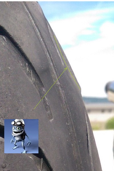

Here's a shot from the side. You can see the lumps fairly clearly. It's very obvious in person, but unless you really want to take an international flight and come for a visit, that's not going to be possible.gn2 wrote:The area in Homie's picture which the yellow arrow is pointing at just looks like a section between two sipes and I can't for the life of me see what the problem there is supposed to be.
Tbh, I vaguely recall there was a brief time in the winter when the tires were slightly under-inflated due to the cold, but that was quickly remedied. That was months ago, but combined with the crappy road surfaces I travel daily, may have been enough to get the damage started.
I have a new tire on order and will install it as soon as I can. I may be able to get it Wednesday and install it Thursday. In the meantime, I have the Piaggio.
- image.jpeg (51.99 KiB) Viewed 3212 times
