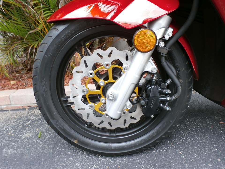

I went with an oversize front rotor and offset bracket 260mm vs 220mm pictured here right after install with 0 miles on it.outlander wrote:After how many miles have people been replacing front and rear brakes?
Is there any aftermarket brake setup that is an improvement over the weak factory breaks?
- PCX Brake 1.png (1.3 MiB) Viewed 3608 times

Is that the NCY disc /rotor? Is the bracket included with the disc? What is the difference between the floating rotor and the cheaper fixed rotor?

outlander wrote:Is that the NCY disc /rotor? Is the bracket included with the disc? What is the difference between the floating rotor and the cheaper fixed rotor?
No, its an Impact wave rotor from webike in Japan. There are various colors available. Yes it comes with the offset bracket. Floating rotors allow the rotor 'spider' to be aluminium so are usually lighter, they allow expansion of the rotor due to heat without warping (not that that's likely with the PCX lol) and they look waayyy cooler.

Is yours fixed or floating, can you post a link please?

Floating, hence the aluminum colored spider and buttons.

Really lol, there's quite a variety of aftermarket rotors and even a four pot caliper out there if you look. Nice thing is one finger braking 90% of the time now, and it looks good doing ithomie wrote:mother honk!!!!!!!! WTF
