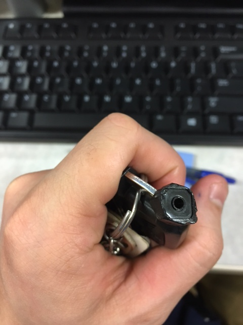

And that's part of my question: is it normal for the shutter key to be showing significant signs of wear after only 2 days of use? I'll admit I attempted to use the key in the wrong direction on my first try, but other than that I haven't had any issue using the key to unlock the ignition switch. Just noticed the hexagonal shaped plastic is all warped and scraped up already. Normal? If this kind of wear continues will it stop working? :?
What has been you guys' experience with the durability of the shutter key?
Thanks in advance, glad to be here!

WD-40 the shutter, it looks like way too much friction is causing unnecessary resistance. Practice unloading any pressure from the steering column when unlocking your ignition. If it won't move stop forcing it until you resolve the (WHY). I don't use mine much but it does work with minimal effort to unlock when i do.
You are not the first to have a tight shutter in here, there was another.

Haha, its been turning without issue since I posted this. Perhaps it just need to break itself in a bit. Still sucks what it's done to my key cosmetically, but not a big deal. I plan on posting my new user PCX photos soon! (I read that's encouraged)
Thanks again guys!
Re: New PCX150 owner! Shutter key wearing down on second day
Keep the key separate from other keys, don't have stuff rattling and jangling against it as you ride along, and don't put it in your pocket with other metal objects. ;)
